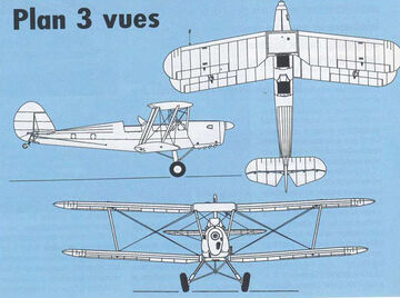

de H 60 G III Moth , essentialy the last Straight wing de H 60 , a derivative of the SWEPT WING de H 82 TIGER MOTH , This was so as the front cockpit in R A F service could be evacuated promptly , with a parachute .
Blatently OBVIOUS if you observe the INTERPLANE STRUTS .
These French STAMPE jobs were similar , but more manouvreable , with Ailerons on BOTH WINGS , both sides , too . :(  :o
