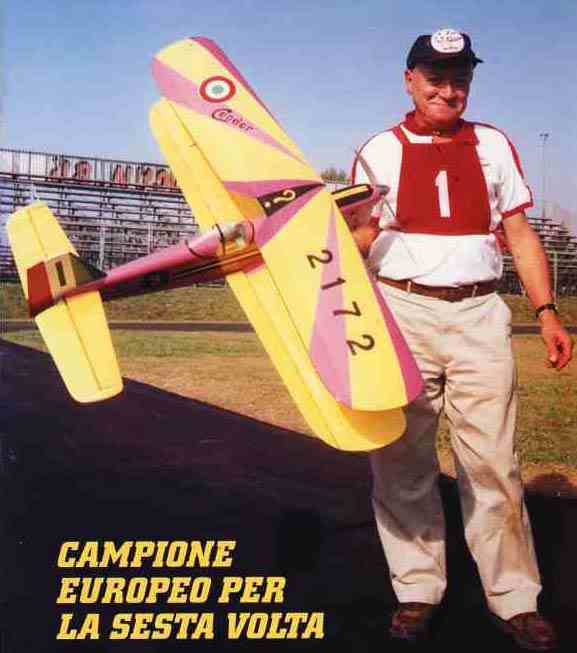

A few years back, I was a consulting engineer for Agusta Helicopter in Coscino di Costa, Italy.
I always timed my trips so that my meetings would end just before the weekend. That way, I could fly with Luciano and his friends.
I saw the Falco fly and it was amazing - Actually, Luciano was amazing, an incredibly smooth flyer.
He was European champion six times, mostly I believe with biplanes.
I never saw the Puma but the Falco was powered with an OS Surpass 48.
Luciano gave me the plans that Matt posted - see that he signed them to me. I still have them.
When I worked in Italy, I was fortunate enough to become friends with Luciano, Clemente Cappi, Alberto Maggi and Massimo Semoli. All really fine people.
But, to the topic at hand, a properly set up biplane works - works very well!
