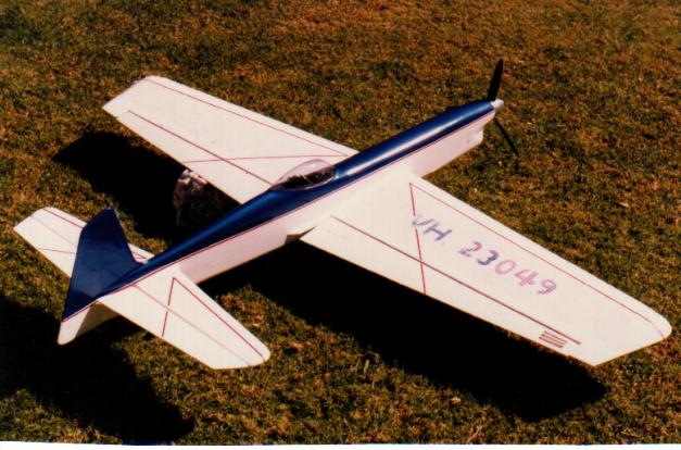

Doonside Mob tried these . Cant seeim to clearly , but theres THREE Spanwise Slots in the Outer Flap at the Outer End .
Er , Yes You Can. Actually . Had to lift it from Orig site . Brian Gardners  88- Reg Towell Caudron  based ship .
Fairly Common earlier on on doonside and assoc Ships .
Id visualised it as a ' Vortex Generator ' to stabilise the outer tip in rough air ,
But Told from the Horses Mouth that at full deflection the air goes through .
Quite Why is another matter .
Probly still on the secrets list .  ;D :-X
Theyre say 1 1/2 ish long , hard edge , like youd used a milling machine . Maybe 1/4 slots with 3/16 or 1/8 between each .

« Reply #13 on: February 07, 2019, 11:54:26 PM »
Well there's a blast from the past. I ended up taping over those slots and trimming the flap chord at the root to get a better turn out of it.
