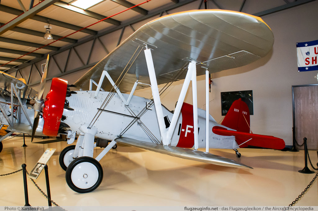

" Build one based on the Sparrow Hawk.  Really good looks! "
AAARRRGGGHHHHH .
WHO is resposable for THIS ( match )  .  S?P
Starting to get Vinage ,
Farnham III bi-plane
