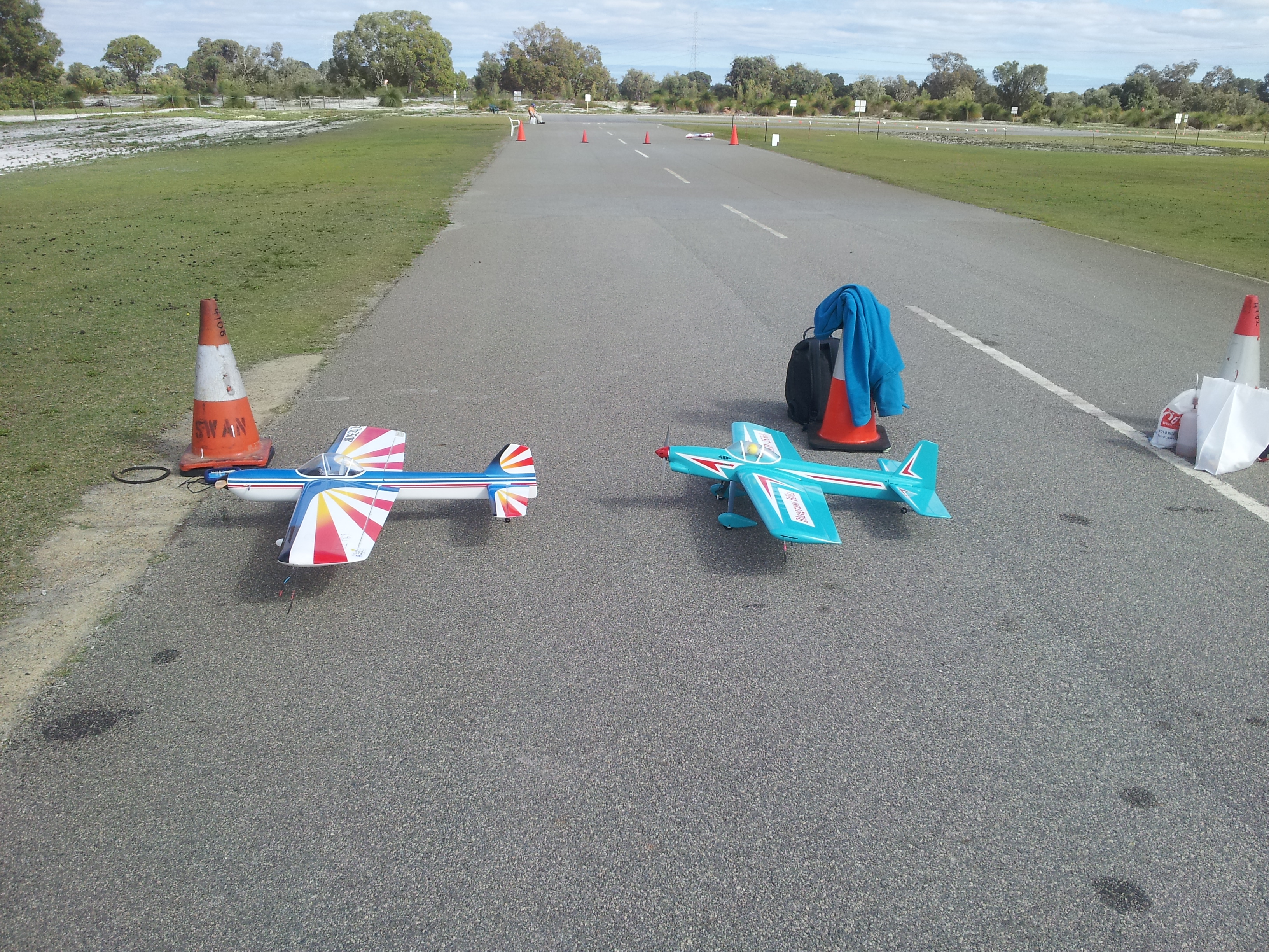

I like the lines also but, I would want to put my aerodynamics AND force arrangements on it too.
That's exactly what I did.
Here's my lookalike at the 2016 WCh in Australia:

 Unless I am mistaken and I could be, there was a KA6, KA8 and a KA10 and I think they were all designed originally by Anatoly Kolsenikov.  Then Yatsenko did one very similar that he called the CLASSIC in F2B.  I think I have my facts straight.  Thanks for everyones input so far.
The Classic next to my KA-10 lookalike that has been made partly of a KA-8 plan with russian text. I have no idea where it came from, too long ago since I got it.
Took ~1/2" of the top of the fin to make it look 'right'. Had to shorten the nose for the heavier motor. Simplified the three scoop air intake to one with roughly the same outer dimensions. Extendeded the landing gear to accomodate 13+ diam. props.
Being based on another non in line design, the wing sits lower in the fuse. But I'm happy, it's my best plane ever.
Compare my 2016 lookalike to the original in France 1990. For sure the american plan is way off, just as mine is.
So I'd strongly advice against using this to create a 'real' KA-10.

« Reply #59 on: August 20, 2016, 07:17:23 AM »
It looks like someone has a REAL KA 8 plan There , Then .  ;D ;)
Not really, just a few pictures from the plan and two 1:1 A4 copies of the canopy area.
For me enough to reconstruct to a level I was happy with, judge for yourself when looking at my photo.
I think I got closer in looks than the american existing plan. That is further off, IMO.
Another point: the KA-8 and -10 are NOT in line designs, close, but not entirely.
The motor and stab are, but the wing is (if I remember correctly)~ 8mm below the center line.
As you can see on my plan, I took some off of the fin, looked more balanced on my model.
