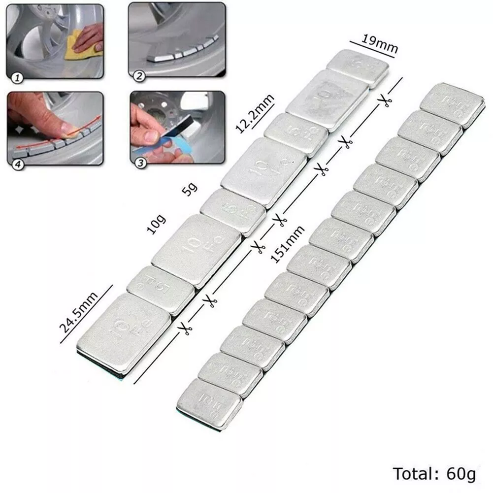

These are about as heavy as this URL is long!  They fold into very nice four-sided squares to line a tip weight box.  I usually add enough permanent weight to gently drop the outboard wing outside of the box. 1/2oz or so.
     That is about what the golf club weight tape looks like. Some automotive wheel weights are steel, I think, as I tested some with a magnet and some older ones are lead. Some are what they call 'white metal" which is a zinc alloy of some kind I think, and some of the weights for pinewood derby cars are also. If you break a piece cleanly and look at the break it will look like it's white. The tungsten weights are the most dense I think, and is usually some sort of scrap in various little bits ranging from small cubes to flat, round dots. It can best be used I think for adding the bulk of the tip weight if you need it and then fine tune with the balance using modeling clay or lead shot.

Wheel Balane Weights .
The stick on flat ones, tho the shiny ones arnt lead .If you must have new ones .
But bludgeing the scrap from a tyre shos balancer , and throwing them in a tin can , then on the stove .
If you pour it into a damp container , youll get lead in the eye , and elsewhere .
Some Thing FLAT  . Custom , one can bend up a bit of alumn. scap . as a mould .
Oven Tray ish thing from a op - shop . But you gotta scraper the slag off . Or
get rid of it , in the pot before pouring , preferably . Lead melts easy , the std weights
you drag the steel claw out after its melting . normally theyre glad to get rid of it .
