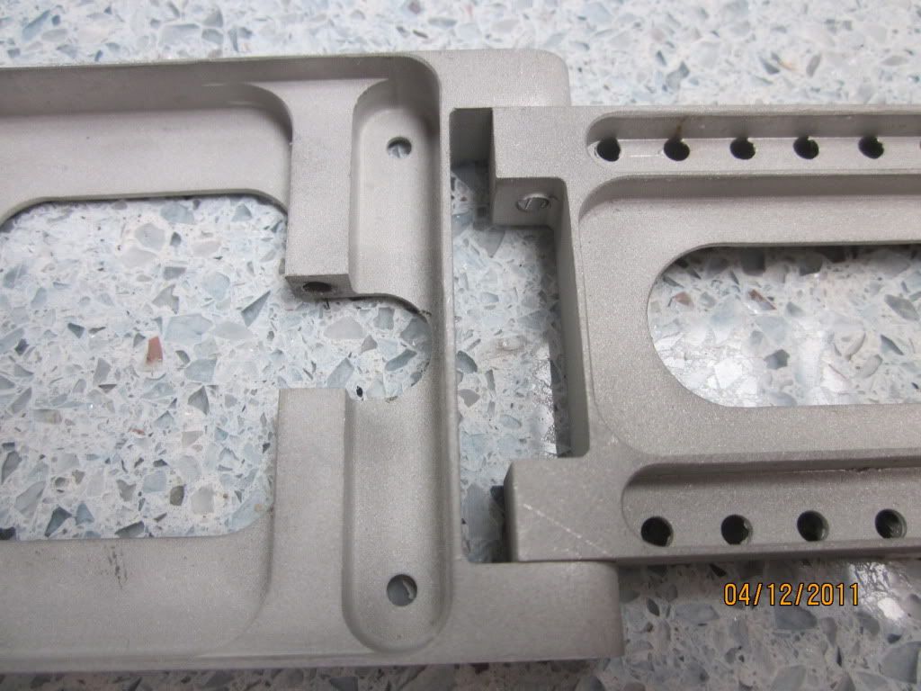

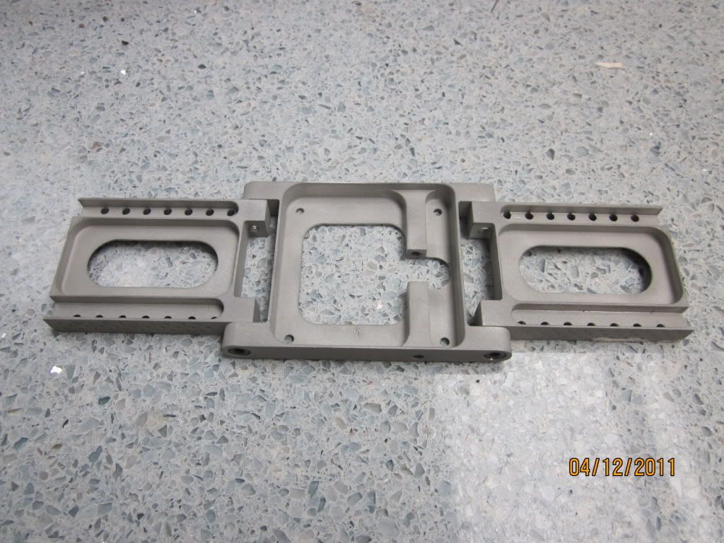

Re: take apart plane
« Reply #7 on: October 27, 2012, 02:49:39 PM »
I use the dallas hannah system. Its based on the yateskno system and its machine work is first class.
I have attached a few photo's of the unit.
Bolts together easily and adds 1.2oz in total weight to the airframe.
I have heard this before, but find it had to believe. I just got a note from Chris Cox who just got a new one for next years project and he weighed it at 75 grams. That's just short of 3 ounces!
I don't understand where 1.2 comes from. I have had them in my hand and they are no way 1.2 ounces.
Not intending to be overly critical, but I simply don't understand.
« Reply #12 on: October 30, 2012, 04:27:34 AM »
The 75grams would be about right Paul, especially for the ones for the .75 size engined models.  I just noticed the post as I've been out of action for near 3 months with real work again :-(  !!   The ones for smaller models would be a bit lighter but I've been making the wing unit part with an I-beam section starting with Dave Fitz' Thundergazer a couple of years back just to be sure.  The Fuz bit is still the same section as original but just thickened up a few thou, once again, just to be sure.   After an initial whoops with my .75 powered large area model back in 2009  scooting around at 4.5 secs/lap on max lines things got stressed a bit!!   Plenty of flying since with updated bits and all is fine but at a more acceptable 5.2 secs/lap!!
The one PJ has is about the same size as the one Chris and his mate have.  Maybe the lower weight is what the difference is when you take into account that there is no bellcrank mount and centre wing sheeting etc???
