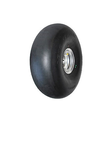

this Aircraft tundra tyre , is untreaded . Likely a smooth tyre , on rouh surfaces , is better with the less grip , so the camber / bump steer isnt so bad . ( cambered / Bumpy surface - directing plane )
Sounds like it'd be better to have a few sets of landing gear , to suit . tarmac , bowling green , and hay field ! .
theres the wheel fairings , to gather grass stalks & trip the plane , too .
