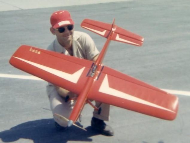

everything is a "modified Nobler"
Case in point.  This plane was accused of being a modified Nobler by a Judge at the '64 Nats.  Not, by the way, by George who was ED.

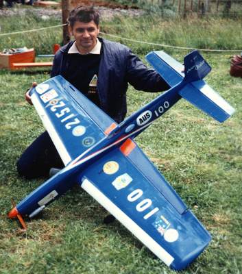

From around 2002 ? Id think say a RE Stalker 51'd be a better idea than the .60 .
a ' Hot Rodded ' Nobler , which I thought typified the ' California Hi Po Custom ' idea
and very fitting . ( Like Greg Ardels 21st century peacemaker ' A Mod mylar / foam/ spuce / 4 rib
version of the Classic flie streak type peacemaker . Id like to try one at 150 % .)
60 in the Gieske . again , the RE 51 would be less overkill , but those .32 ball race schneurles are too .
Excess mass can get the inirtial effects visually apparent .

The Real Mc Coy .
oops . " Greg Ardill " / greggles47
LE is commercial 3/4" (19mm) preformed, backed by 1/2 x 1/8 spruce (full length)
Spacing is worked out by the following formula:
Put in middle ribs (the big ones).
Put in tip ribs (the little ones)
Put on TE. (Drawn as 1/4Sq - spruce) Mine has 5mm Carbon
Put other ribs where they fit best between LE & TE.
Wings are equal length.
Ribs and tips are 5mm balsa
G'luck mate.
_____________
N.B. the wings of something else with another name , not exact plan outline , a Common Combat thing .
Er , RIGHt . Now - if you did THAT to a NOBLER , and scaled it up 150% ( Just to get us back on topic  ;D )   LL~   8)
My views its one of those things thats more than the sum of its parts . One of those accidents of evolution .
