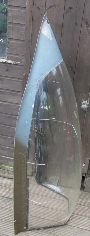

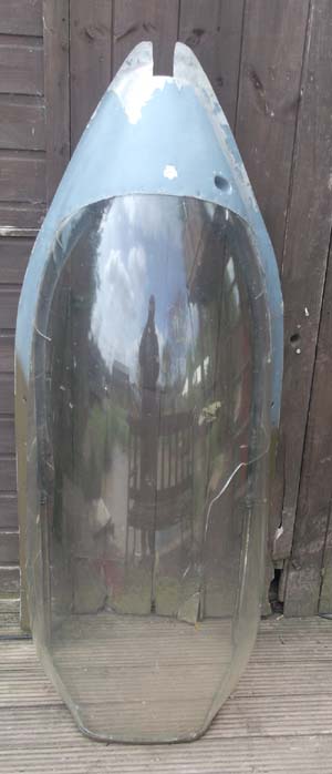

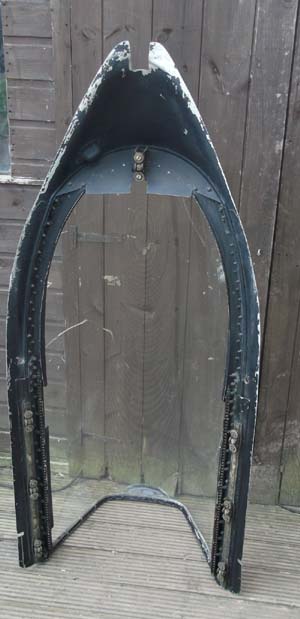

The BEARCAT & Typhoon / Tempest Canopies were closly related . The P-47s a trifle larger ;
Though the Bearcat is almost a similar shape .
Ive got a plug for a P-47 Razorback & Bubbletop & a dozen others , with a accurate shape -
about the size youre after . But its ' raw ' - unvarnished at the moment .
Razorbacks actually ' teardropped ' at the upper frame line . NOT parrallel sided .
 S?P
Unlike this one .  ??? Its also teardropped at the upper sill , the lowers parrallel for the runners .
Was a plastic 1/48 kit review , lambasting most p-47 kits , bar the one that matched the inaccurate drawings he used .
 VD~
while we're there , we'll have a fit about FRAMES , for some reason the manufacturers at this stage went to great lengths to REDUCE DRAG . Therefore 2 x 4 frames are generally innapropriate , they were darn near FLUSH . ;D
F8F
Tempest
you can see the frame at the windshield chopped square from the F8F , which is more bulbous at the front shut face .
Course the winshields are somewhat differant altogether .
Typhoon
yours for 1499 pounds !  :P
