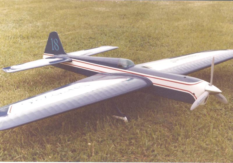

  Haven built several Juno's I can tell you this. The published Juno had built up flaps ,airfoiled but there were some built with flat flaps by Billy. Also the Juno has a larger stab percentage wise than the Super Ares. Billy built several sizes of the Juno design starting with a .35 size one long before the .46 size one was published.  I do have pictures of all of them if there is interest. The Juno airfoil is the same as the USA-1 at the center but is very thin at the tip because of the large taper in the wing. Alignment on the Juno is the most critical of any model I have ever built.
 One of my last Juno's with reshaped rudder and geodetic ribs.
