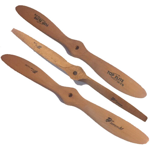

Theres old Top Flight 3 1/2 inch pitch Free Flight Power , props , and the old grey Cox / Rossi .15 type, too . If you really got Revs .
Matter of the WEIGHT , too . Thats related to the BLADE AREA . Having flown a twin or two . The Old Nylon Top Flight work better vertical ( up ward )
so give a more controlled run , than the Tornado . Wich are dead rigers for their wood props . So Those - Treated with timber oil to reflexify , are o.k.

Try a few . Not Neccesarilly the same either side either ! Trim or thin or narrow a few unhappy props , if its no loss . But old Top Flights hook in good , going uphill . Keep on keeping on.

I prefer the 4s or 5s on I. C. , maybe tornado 8x6s if its hot & high . On FPs in the 60 ounce things . On Veco's 5 20 % got 90 from the Mosquito , in a speed comp . All about that weight.
If you trip ovr any of these , lube em up , and have a go . Theyre a good prop for our r.p.m.s , seem to have a bit of load response , not slippage . and ease off otherwise . Like a ' V ' ee engine .
That might be a higher pitch one , in the middle , there .  S?P  ( can help to visualise extreemes , to get a hold . As it were .)
