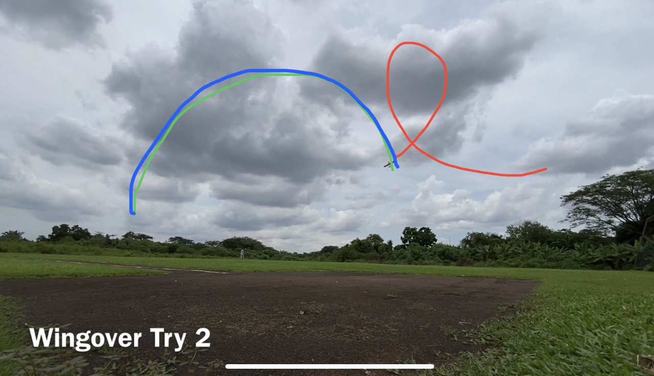

Hello!
I just wanna give you an update of my progress.
Today, I just did 2 (ugly) inside loops, too bad I didn’t record it.
So, I'm just gonna write it down how it went. Hopefully it will be understandable enough.
My inside loops attempts today actually started when I was doing a wingover on my first flight.
At that moment, I just wanted to do the wingover but I guess, somehow, I accidently did input an up control by my wrist movement when the plane was about overhead, and it made the loop. I was surprised that the plane went into the loop manuever thus I was late to recover into level position due to my confusion whether I should complete the loop or the wingover. The plane crashed. Luckly it was hitting a soft ground with high grass and only the propeller that was broken.
Eventhough the plane crashed, knowing that the plane was capable of doing a loop, I felt excited that I would have the chance to make my first (intended) inside loop on the next flight.
After replacing the propeller and did another pre-flight check, the Banshee took off.
The engine was quite slow or seemed underpower (haven’t measured it with a tach — should be on my next list).
But thanks to the uniflow metal tank, the fuel distribution was good and stable for the entire flight.
In the middle of this second flight, I encouraged myself to try doing the inside loop.
I stopped turning and take a stance, I moved my arm as if I was going to do a wingover, halfway through when it climbed and hit about 45 degree, I tried to put some wrist movement, and it suceeded to make an ugly loop. I tried this twice, both succeded. The loop happened at about 45 degree angle, not really straight in front of me as I imagined.
*(for the wingover, I tend to use my arm movement more than the wrist movement)
At the end, the plane landed safely.
Did I do it correctly? If I didn’t, what should I change before it becomes bad habits?
Big thanks :)
Kafin
Edit:
Trying to support with a photo for a better visualization:
Here’s what I tried to do today:
- Moved my arm as if I was going to do a wingover entry
- At about that height and angle, instead of letting the plane to go over above my head (green-blue lines), I pulled back my handle with more wrist movement and it turned out to be a loop (red line).

Did I do it correctly? If I didn’t, what should I changed before it becomes bad habits?
Yes!  There is no wrong way at this point, and you will have plenty of time to polish technique before bad habits become muscle memory.  The best thing you did was stop turning and face the maneuver.  That needs to become habit.  In many ways learning to do the round maneuvers is like driving a car.  Do you consciously think how much to turn the wheel?  As you get more experience flying will be like that.  Your eyes steer the plane and your fingers, wrist and in some cases elbow, automatically give the plane the required control.
One caution - wrapped lines can make a plane very difficult to fly.  I would not do more than 8-10 loops on a single flight until you learn the outside loop so that you can unwrap.  Anything under 5 is hardly noticeable but it changes fast after that.
Congratulations #^
PS - once you have the loop going well your next maneuver should be the lazy 8.  It is the lead-in for both the outside loop and inverted.
Big thanks :)
Kafin
    Sounds like you are in the ball park.  Now just repeat it a bunch more times. Rule book loops top out at 45 degrees, but you don't have to worry about that at this point. just get them up and over the top, back around and recover level flight as smooth as you can.  You have the whole sky up to 90 degrees over your head so why not use it. At this point in learning, it's time to focus on understanding that you fly the airplane completely through the maneuver. You can and sometimes you have to make adjustments as you go through the loop. Getting used to the feel of this is easier if you make the loops big. If you do the loops too small you are at risk of stalling the airplane and maybe crashing. It's just like steering a car or a bicycle, except that you are not in it or on it!! You are steering the airplane 100% of the time it is in the air.  Just keep doing them so you get comfortable.

Kafin,
I'm glad to hear the Banshee survived a crash and went on to do two loops!

Thank you Ken, Dan, Kevin, and David.
It seems polishing the wingover technique is very crucial as its climb part will be used as the ‘entry’ point for most manuevers.
I’ll try to make a video next week, hopefully it will go well.
