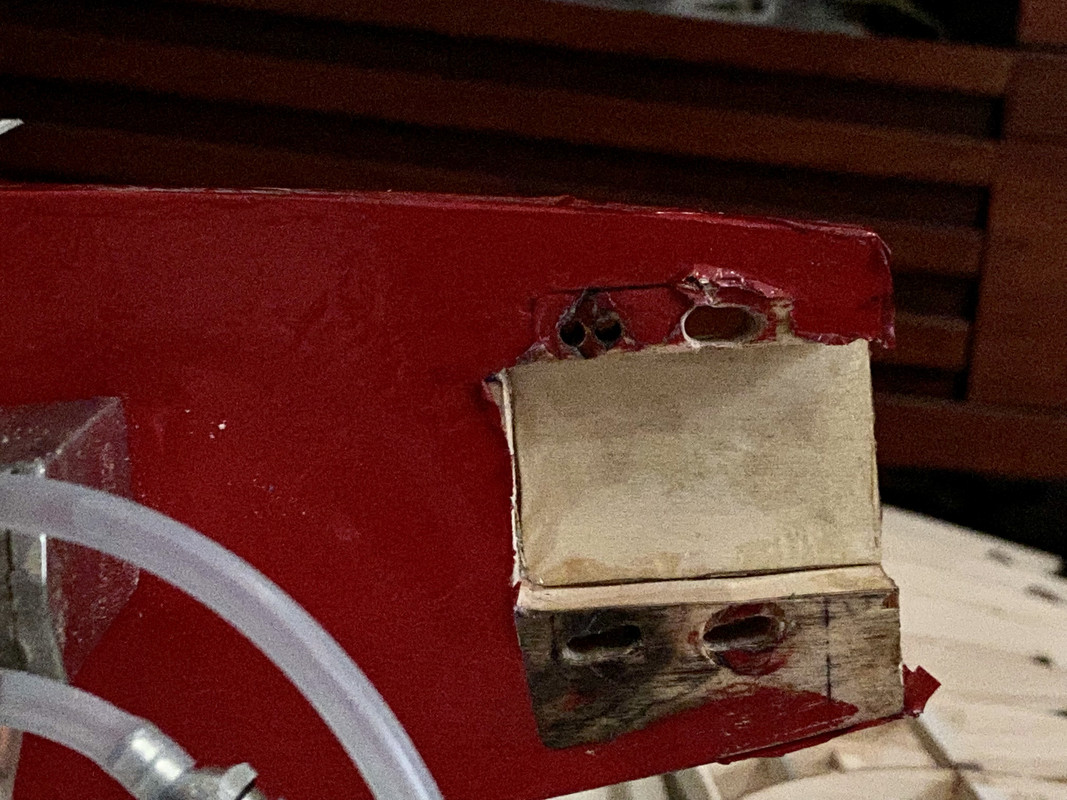

However, I also have another ENYA SS40 BB (second-hand from shtterman Ebay, has been broken-in) which I’m going to put into my Banshee just because I’m getting tired dealing with my OS LA-S 40. For this engine, do I need to do as you mentioned?
I was told to only run it really rich for a while to get plenty of castor, run rich but not like a full break in.
And since the dimension of ENYA is a bit bigger than the LA, I just enlarged the mounting but I messed up when drilling the bolt hole. Is it still okay to mount engine with this loose hole?

I would put some metal tubing sleeves around your mounting bolts through the fuselage from the outside then epoxy them in and fill any open spaces with epoxy then file them even with the mounts.  I do this on all of my planes with a metal to wood mount.  You can also put thin plates on both sides, most importantly the outside.  Exhaust and fuel will get in and the motor will loosen easier if you leave the holes unattended.  However, if you keep it tight and use larger than normal washers on the outside, it will stay on, but it will be more prone to vibration and oil soaking.
Don't forget the weight.  It will fly differently if you don't rebalance it to where it was before.  Just be prepared on the first flight.
Good luck - Ken
Yes, thank you Ken!
This is exactly what I was thinking.
Might probably be using the rivet nuts as well.

Thank you so much for your reminder.
I will definitely do what you have suggested for my Brand New ENYA SS40 BB.

as far as the elongated hole, you are fine. I suggest you use a 1/16 or 3/32 aluminum pad that is larger than the engine mount to better distribute the mounting  pressure on the wood.
