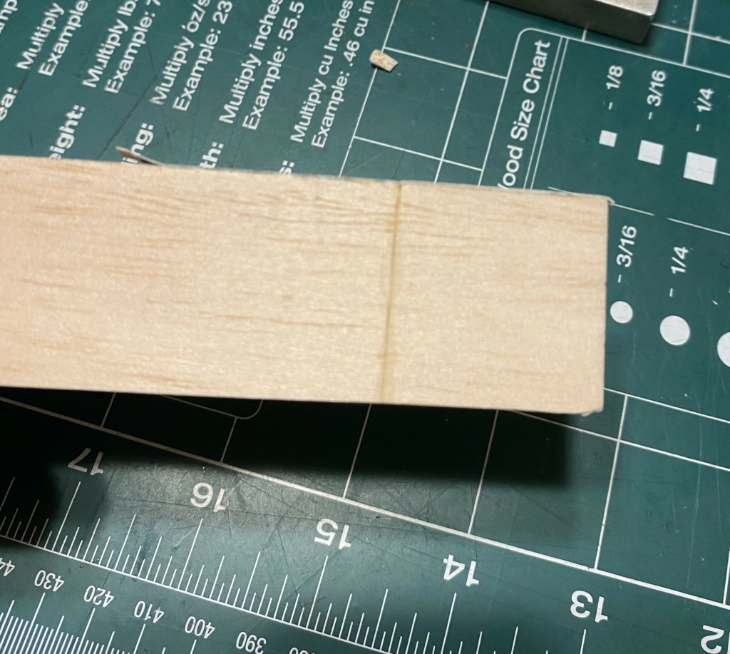

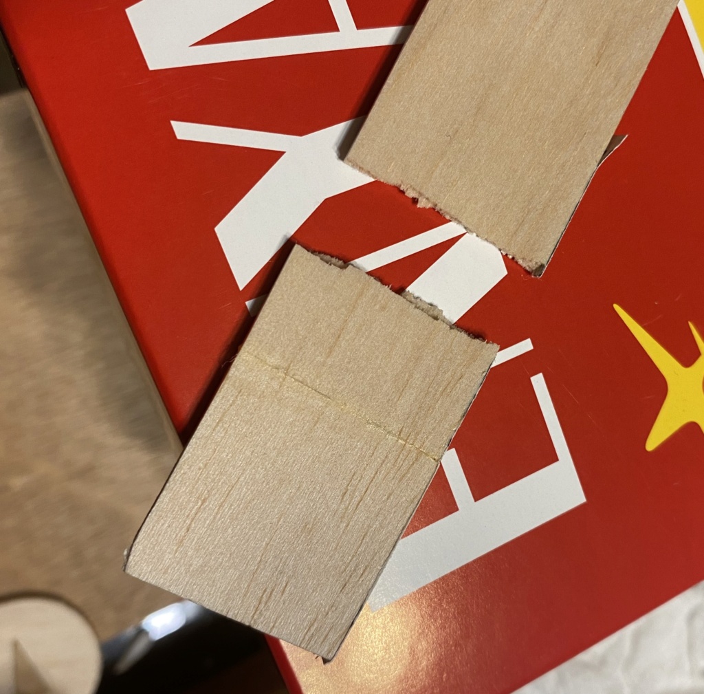

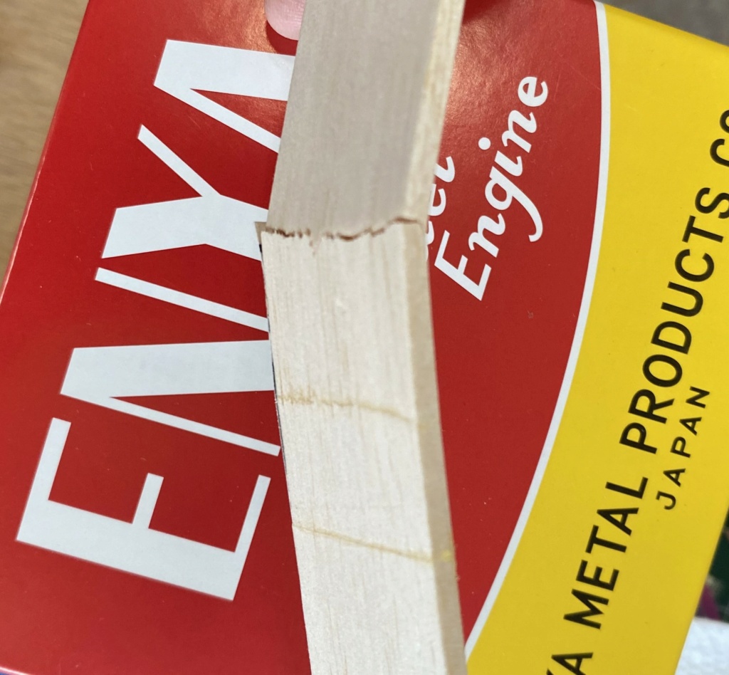

Hello Dallas
                             I found out what I think is the best way to butt join balsa that will work real good. the first thing to do is to dilute original titebond wood glue with water. then using a small brush you paint the butt ends with the diluted glue and let it dry that way the glue is absorbed by the wood fibers. Once dry you can use full strength titebond to join the sheets. Place them in a flat surface and remove the excess glue from the joint. I use Qtips to remove excess glue.  I place wax paper under the joint and on top and place some weight on top until it dries. You can practice on some scraps of balsa. I used some soft balsa 1/8 of an inch and there is no need to use a doubler to reinforce the joint as it come out very strong. I broke the test piece and it broke but not at the glue joint.
                                                                                                                                                         juan
