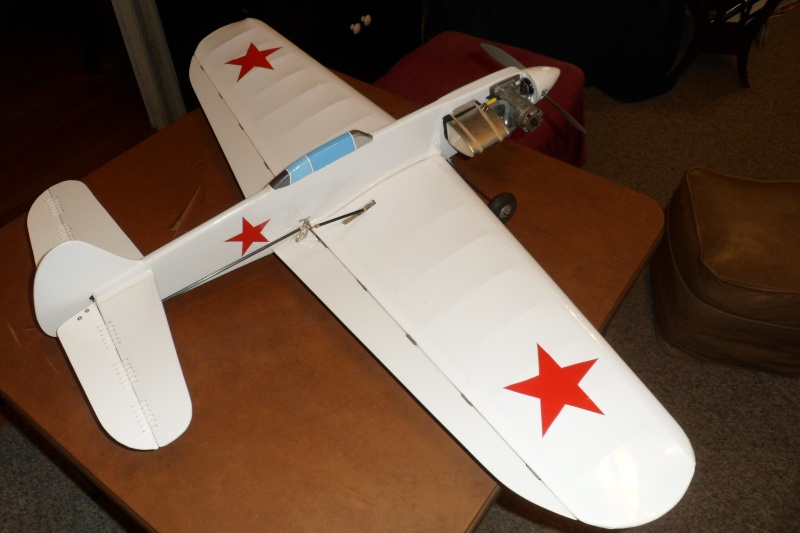

I finally finished the Yak-9 I've been talking about since I joined SH. Now I want to make decals and bought clear waterslide film for inkjet printers. Six sheets for $12 bucks. They need protection from the slimy smoky old Fox 35 and my cleaning with alcohol. I'm wondering how to seal them without ruining the ink. In the past I've lightly sprayed Lustrekote on kit decals with success. Anyone have any experience with these?
Here she is. Maiden is set for Tuesday. Those stars are Monokote. I want to make a red Russian text decal for the nose under where the exhaust pipes still aren't. Also a number and something for the rudder.
Rusty
