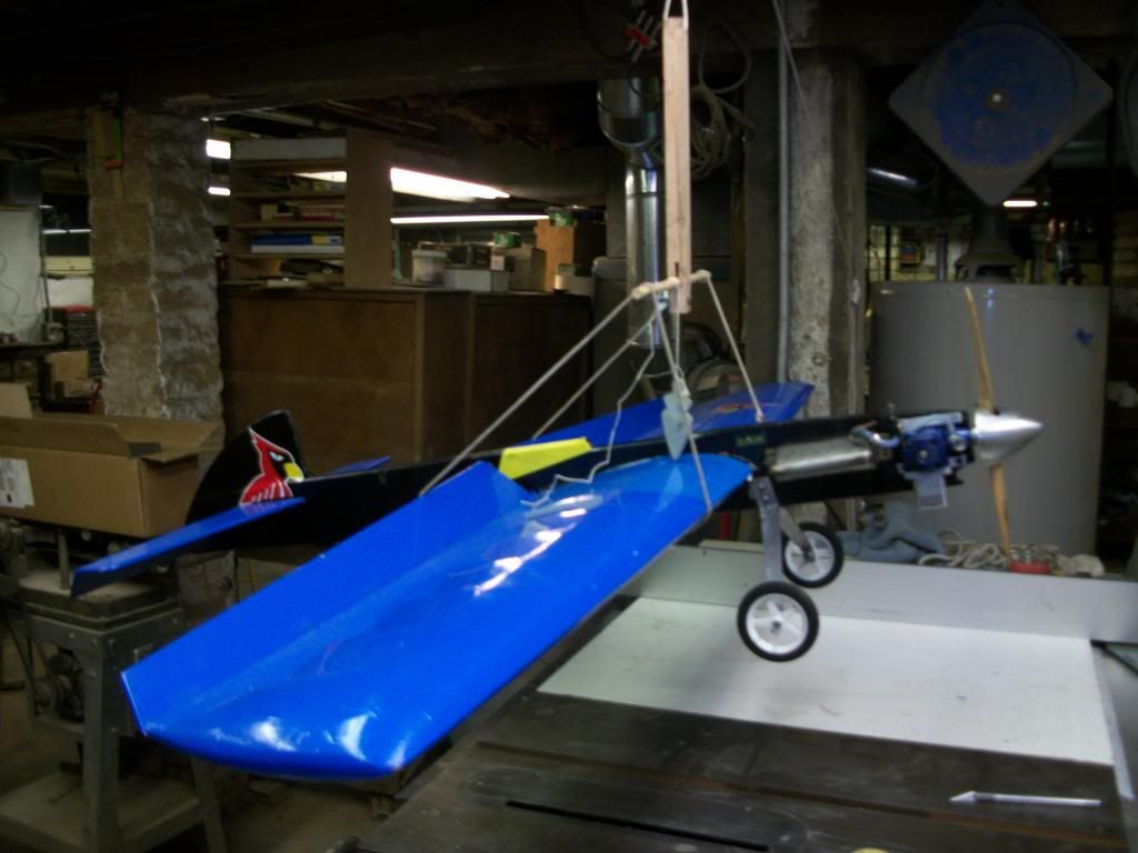

Found this surfing the net this morning. I thought it was pretty slick, and made it with stuff I had laying around in about 1/2 hour. Here is a link to the page where I got it for building instructions:
http://home.mindspring.com/~the-plumber/Vanessa%20CG%20Machine.htm
Anyone know where a Cardinal is supposed to balance? This one is just about dead on the spar. My kid likes the way it flys, I don't think I should mess with it

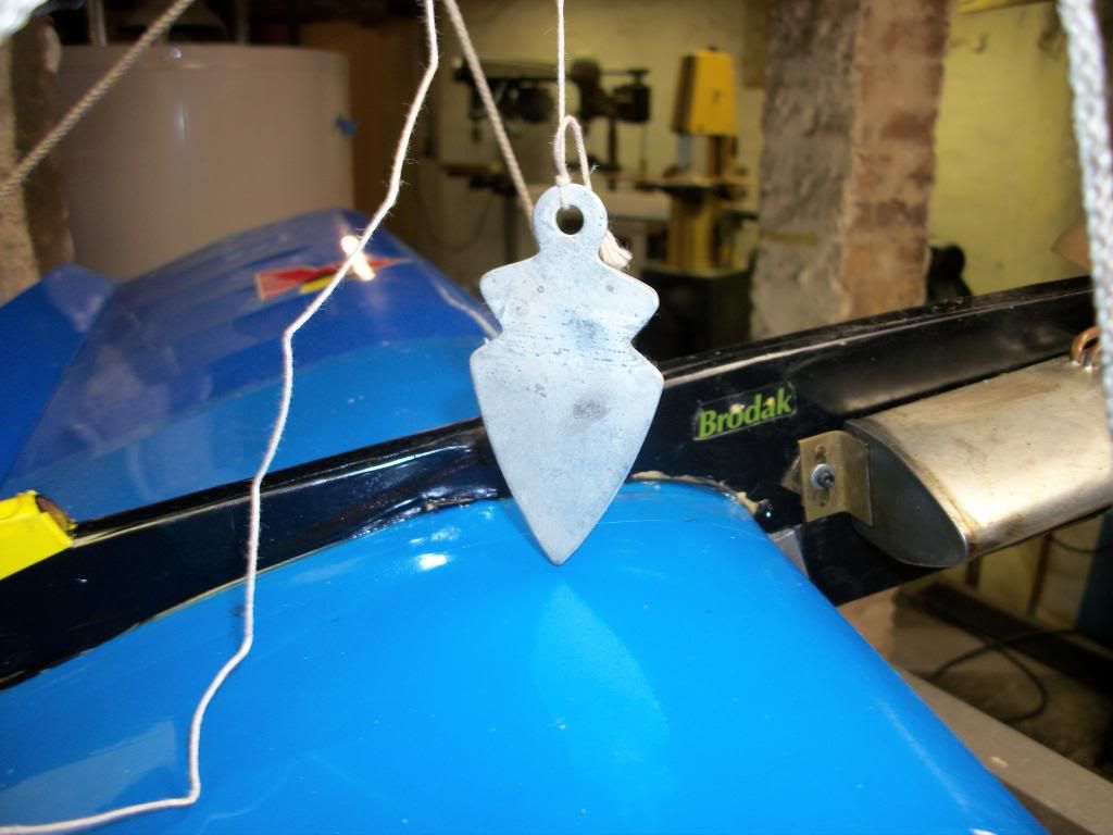

You probably already know this, but the plumb bob points to the spot inside the wing where the center of gravity resides.  If you want it to point to the spot outside the wing where the center of gravity is located fore and aft, then you need to have the plane level (think about it).
Moreover, if you make a harness by tying all your strings to a point, then you can measure the side-to-side CG (which, on a CL plane, should be outboard of the center thanks to tip weight).
I think I'm missing something maybe, but unless you are balancing something like a canard, isn't the balance point always in the wing, generally 25% to 35% back from the leading edge? For what it's worth I went back downstairs and leveled the plane, the balance point indicated changed 1/8" at most.  ???

The CG isn't just somewhere between the leading and trailing edges -- in the case of the plane you show, it is inside the wing.  In something like a Piper Cub, it's below the wing; in a low-wing plane like an Ercoupe or a P-51 it'll be above the wing.
Maybe this drawing makes it clear.  The pointer always points to the CG, but you've moved the wing around the CG by changing the tilt of the aircraft.

Okay, I understand now, nice drawing! The 1/8" difference I observed was merely from the tilt of the aircraft. Leveling the plane would give more accurate results. Wouldn't this device be adequate in determining whether tail or nose weight is required to get to a certain point?

That thing should be great for determining the CG.  I should build one myself!

It is easier to check with the model upside down and hanging from the LG.  Check my posting on http://stunthanger.com/smf/index.php?topic=25141.msg242498#msg242498  That dowl contraption doesn't work as well as the one I made (I tried it).  I didn't invent this one either but it works!

Mike's gizmo is what I was talking about when I mentioned tying all your strings at one point.
