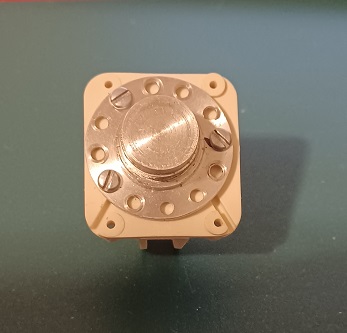

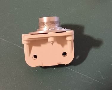

The thing now is, what do I do with all the planes I built for the Brodak mounts?  Okay, time to put off unpacking and go to the parts box I already unpacked.  I have a couple of the Texas Timers .049 TD/Medallion radial mounts in the bladder drawer waiting to be used.  Hmm…  Okay let’s take the new Brodak mount and see how the TD/Medallion radial mount fits.
Awesome!  Let’s see how it looks with a TD .051 with Kirn Kraft needle valve.
Awesome²!  I can get a couple more of the radial mounts and have two TDs and two Medallions that I can swap out between the different planes.
Texas Timers no longer sells these radial mounts for the beam mount engines.  But, these are now being  made by Kamtechnik.  Kamtechnik also makes the radial mounts for the TD .09 and .15, as well as the Norvel .049/.061/.074 engines.

                  Mark, Brodak makes two kinds of those mounts. The one your depicting there is of a plastic which is somewhat beige in color. I use that mount but it's a harder plastic which I've had crack around the screw holes which retain the engine. Brodak makes a identical mount which is more of a translucent look which is white and is a lot more flexible. I've found that particular mount to be more durable and the ones I've had are now going on 10 years. I saved the one in a bag but the funny thing is it's the same number as the beige version.

I designed that mount for Brodak, and it was supposed to be virgin Nylon 6-6. Those are almost bulletproof. The Devil is in the details as this and the latest batch of “rubber ducky” props show by bad plastic choice or molding techniques. Bend one and you will see surface cracking. I am not brave enough to test such a prop by running it. Sorry, that is my observation. I would love to have the original bullet proof props. Virgin 6-6 Nylon with no regrind and careful mold control do the job.

Motor mounts are not so critical, but they could certainly be improved with a bit of carbon or glass fiber in the mix. But durability versus rigidity is a tradeoff to be considered. Tough trainer or precision flight. It would be nice to have that choice. Trainer and Professional versions. Not too hard to sell both. Just change the mix going into the tool.

           Certainly a nice piece there Dave. I did find my mount as I put it aside. However, as Mark mentioned, the new ones are black plastic. Who knows maybe they changed the formulations through the years. When I mentioned the beige mount, I've had more than one of these fail and not from ground strikes. They were in storage and dried out and I noticed the splits that formed around the screw holes. These mounts however are probably 12 years old or better. Certainly not a complaint more of a observation.  I just happened to notice that the milky white ones were more flexible. What I also noticed is that the mount that came with the Brodak Baby Clown ( First edition) is extremely flexible . They're also a tad smaller than the Brodak mount. I can't post pictures on here as I find it to be a pain in the rear.
