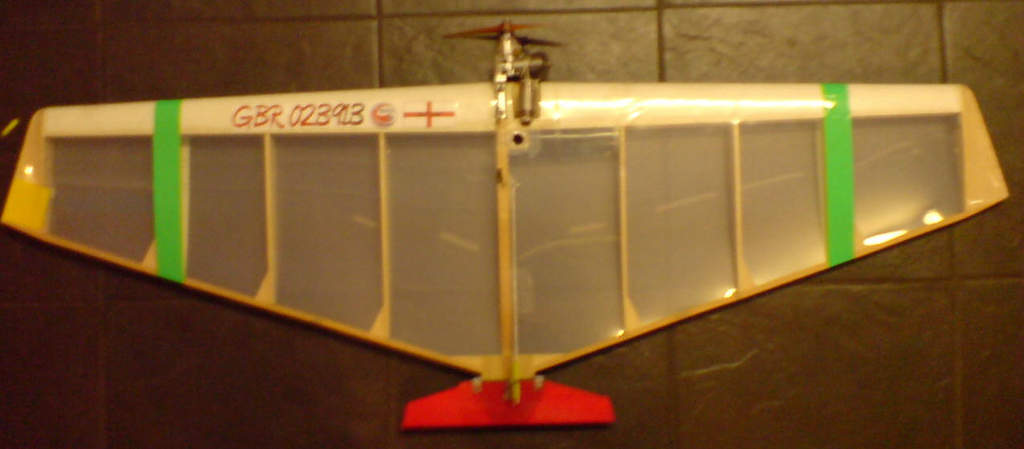

Flying one of Gibsons Cockroach Combat wings , with a Diesel in it , Fwd a tad , on 55 ft lines ; looks just like this :
Tho light on the lines and responsive to small handle movements , grooved superbly . Enough to recomend as a scedule ' learner '
economic masterpiece. Theyre called Cockroaches as theyre hard to kill , Mr Gibson related . ANYWAY , just saying . :-X
