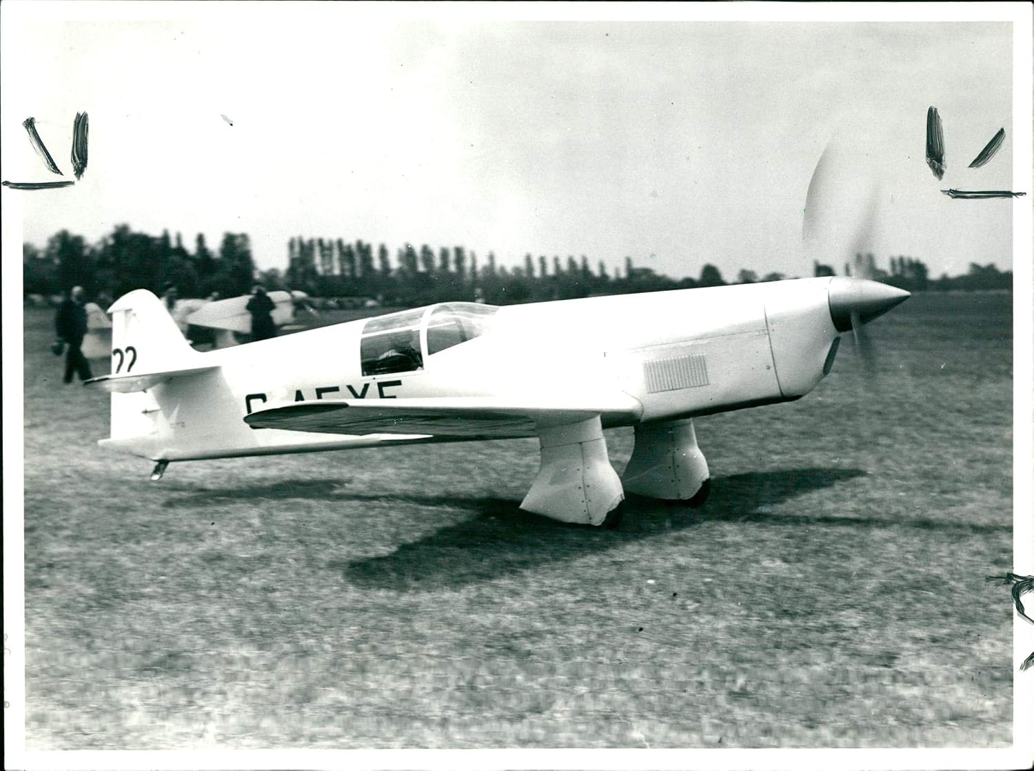

« Reply #110 on: May 08, 2016, 06:58:43 PM »
I must read the ' painting & finishing page , one of these days .  ;\
We'll blame JackSheeks for that. Wheres my carbon tetraflouride ! .
http://www.autographs.se/exp/henshaw%20eheim.jpg
Took forever to find it, again . whah Hoo .

Well , ive ' resurected the thing . New Fuse , + 1 1/2 inches aft . Did the Fuse. for the Staler 51 RE . but since fitted for FP 40 . Dunno if this was a mistake . :(
Redone the spare cowl for the FP . Heads inside . Stalker head would protrude plus would need a cut  out for muffler air exit . So the logic was ' keep it clean ' rather the orifficated .
Will see if some pictures ' go on ' .
one of the Full Sized , anyway .
Getting inclined to do another ' green ' one , for ,maybe the Merco 61 . THAT original was with a Merco 49 . Darn Good. Hot Ship . Pointy Spinner .
V differant to fly to this ' High drag ' version . Ive increaed the flaop chord to loose the thick T E . Had to reskin, again , the top of the elevators .
ANYWAY , ready for tissue covering . Tank Bay , cowl etc etc all done . Hopeing it wont ' trip up ' on the small wheels. Now . But figure dragging some carpet to the field might get it running free . If needed .
Would be o.k. on tarmac. Dunno if the new Nats Site has the Stunt Circles tarmaced or just the T/R & Combat .  VD~ S?P
