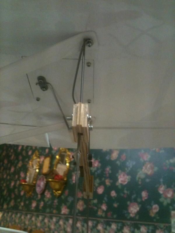

Mr Mulligan ,Electric, Converting for Scale C/L . Question is how strong does the Lead Out guide have to be? See pictures. Do I need to brace it with
the wing  struts? I Am going to add a piece at the bottom of leadout guide wire attachments <a href="http://s82.photobucket.com/user/kickercoach12/media/IMG_0340.jpg.html" target="_blank"><img src="http://i82.photobucket.com/albums/j262/kickercoach12/IMG_0340.jpg" border="0" alt=" photo IMG_0340.jpg"/>[/url]<a href="http://s82.photobucket.com/user/kickercoach12/media/IMG_0339.jpg.html" target="_blank"><img src="http://i82.photobucket.com/albums/j262/kickercoach12/IMG_0339.jpg" border="0" alt=" photo IMG_0339.jpg"/>[/url]

I can't give you numerical answer, but I will say.
It might carry a lot more stress than you think.
If it fails the whole deal is over.
Don't underbuild it.
I've built several biplanes, pretty much the same deal, except you have to wings to brace against.
I recommend starting low with a lot of line rake.  After a test flight you can bring it into trim.  That beats starting high and forward and not having anything to trim.

My most recent high wing Rearwin Speedster:
 64", 6 pounds.
 Leadout guides .032 wire - almost no flying load on them (screwed to bottom of the wing).
 Line rake: (center of the lines) 2 degrees to the rear, behind the center of gravity.
 Line elevation at the leadout: Same as the thrust line.
Flew right off the board, no adjustment was necessary.
