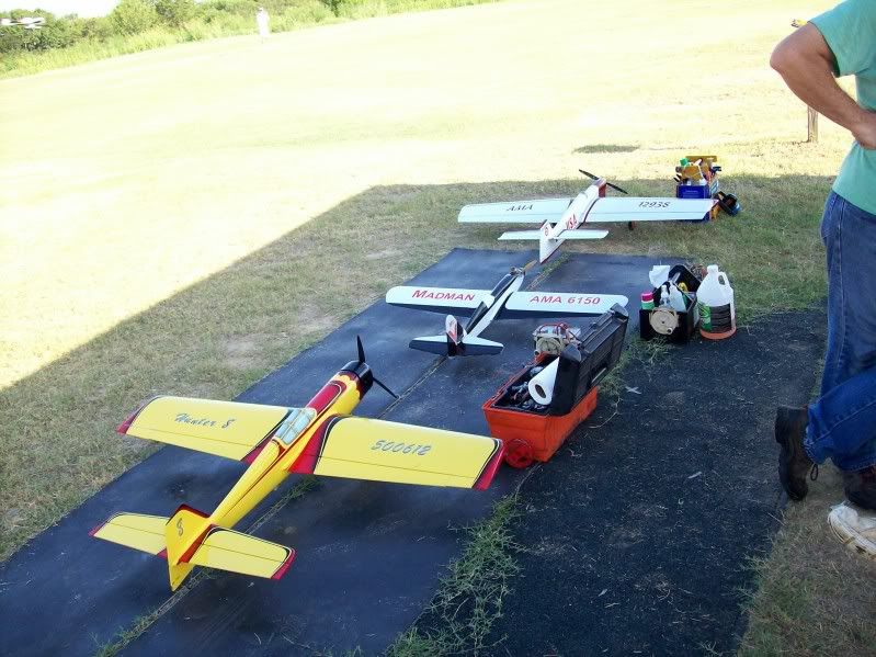

Today we had a TAG event at the field, and before the kids arrived we got in some good flights. Here's the guys..
Some nice planes (Bill Wilsons Hunter 8 in the front):

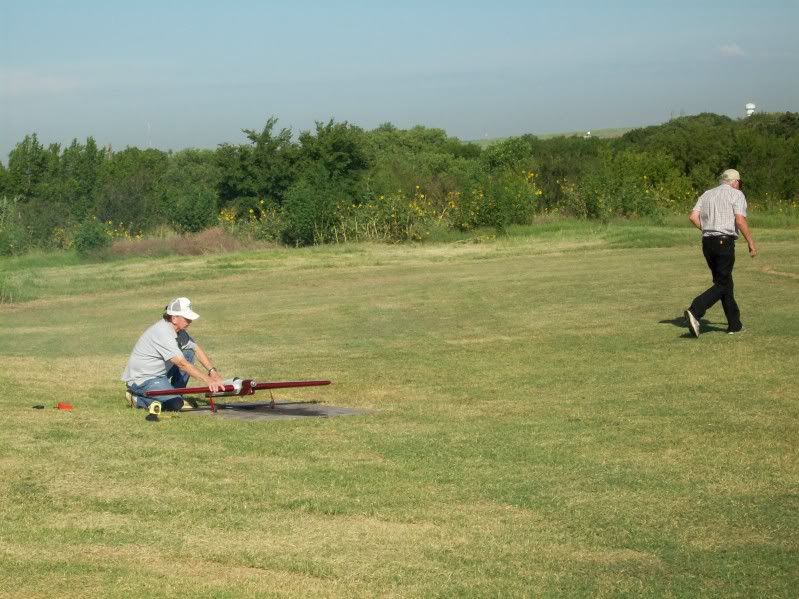

Dale Gleason running to the handle as Tom Farmer launches:

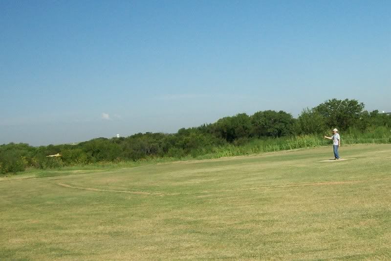

Tom Farmer wringing out my new Nobler:

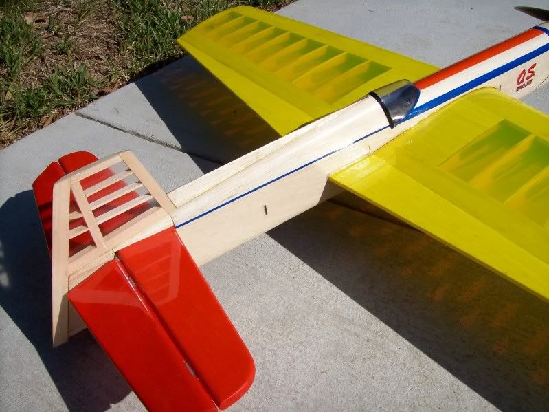

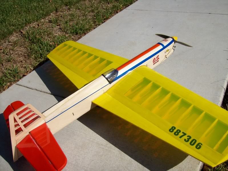

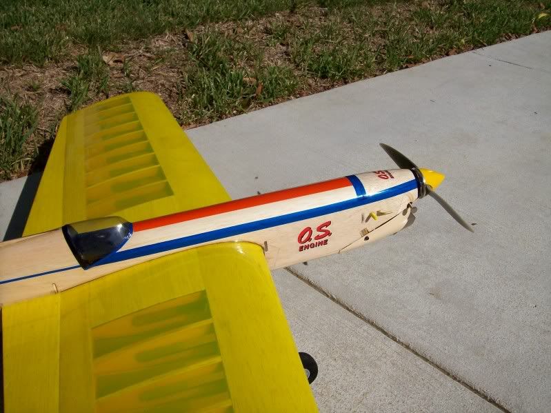

The weather was great and the flying was good! I have the new Nobler flying and fly it does! It is a UHP G Nobler with no flaps. It has a OS 35S with a tongue muffler spinning a 10.5x4.5 APC prop. It has a 3.5 oz. uniflow tank and the run is excellent. 3.5 oz. turned out to be plenty in a good 2 cycle run. The plane came out at 39 oz. and the big question was "Will it turn???" Simply put; YES! it turns excellent and is very easy to fly. It simply doesn't need flaps. The covering is SLC clear film and Monocote transparant colors. I did not taper the fixed flaps and they have a squared off trailing edge. I think I am going to enjoy this plane...

I am not surprised. The Magician IMHO always flew better without flaps. Flaps are about weight. If your plane is not within that particular weight regime for flaps, then, is no reason why you have to have them. Remember, flaps produce more lift but, the by-product of lift is drag!! Now, that same Nobler at 49 0z. would probably need some additional lift in the way of flaps to keep the party going.
That's what I was thinking but I had to try it to see. I am definately not disappointed with the results! y1 I figure I could always wonder if it would work, or just go ahead and find out for sure.
