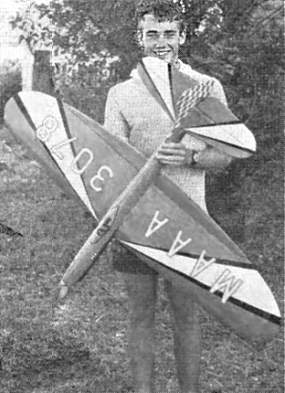

  • Posts: 5250
Re: Wings aspect ratio (slenderness)
« Reply #14 on: June 15, 2017, 10:19:46 PM »
Was going to put this on as a example of a highish A/R . But its 5.5 : 1 odd .  LL~
