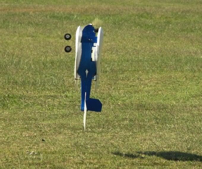

This is a Winning Wingover.

Looks good but the truth is in the inverted pull out  ;D

What I find interesting, is that the plane is nearly vertical by now and how much (or how little) it has travelled vertically from level flight.  As you can see, there is still some down elevator applied.

Looks to me like the flaps are down...the elevators could be either down or up, not sure, but if the flaps are down, the elevators are up! We're definitely looking at the bottom of the model...pipe and LG clearly visible...plus I know Brett flies CCW. Most of our West Coast guys fly good, hard, corners.
Lots of guys get low pullouts, some even without a hop afterwards. But not that many actually go straight over the top of the circle, or follow the same path twice, or align it with the Judges even close. To me, that's the real deal killer. The RWO needs to SPARKLE...a really good one will get the Judges attention and put them in the mood to give you an extra point here or there.  y1 Too many guys seem to treat these "easy" maneuvers as a place to relax. Nuh-uh.  n1  Steve

Steve,
You're right, it's on the upright pull up.
Crist

Look how much the plane is turned out , I have noticed on Elwyns pictures that our planes are flying in a crab. In full scale we would call it a half of bubble out. Good job Brett on your wins
Easy?  ~^  I've always considered the RWO as one of the hardest maneuvers we do, especially coming so early in the flight. Anyone who can nail one right out of the box will get double kudos from me.  #^

Personally, I believe the inverted pull out in the RWO the most difficult maneuver in the pattern.
Coming over the top and straight down makes finding a reference much more difficult than finding the bottom for the outside square.  The outside square has a "straight and level" reference at a given altitude.  The wingover does not!
The straight over attitude of the airplane makes timing the maneuver much more difficult.
It's definitely the maneuver that separates the "Men" from the "Boys".
It's also the one that tells the judges where you will be in "score".  Just my opinion!

This is a great example of gyroscopic precession in action... note the amount of yaw out while the model is turning. You can bet that Brett doesn't trim the model with that much yaw in level flight.

     It doesn't look all that yawed out to me. Of course, it does tend to weathervane when on the upwind side of the circle, and, the yaw angle tends to lag behind the tangent during hard cornering. just from inertial and kinematic effects. I wouldn't jump to the conclusion that it tells anything about the precession.
    The only thing that surprises me is that it's that close to vertical that close to the ground. All week, I was really swooping into the upwind corners to make sure I got it vertical, and even the pullouts (which were much tighter) looked ultra-soft from the inside. Everybody else told me it was cornering very well, so I take their word for it. I would estimate that this is only about 10-12 feet up, and it started at 5 feet, which suggests a radius I just got done proving was impossible.

Hi Brett, as far as the radius, it might be  case of the "skidding" that Isky (??) showed in his stop action high speed pictures.  The great optical illusion!  The plane is pointed up but might still be sliding forward in relation to the ground.
What 'cha think??

Look at the prop, you can see all three blades. Now look at the highlight on the top of the flap and the shadow on the top of the elevator. The model is still in rotation, still feeding down from the handle, and not quite vertical. 5' Radius is remains impossible.

Hey Brett look at the picture again.  I think it was ovr cast as I see no shadows on the ground.  Sure this wasn't finals day?   By the way well deserved win.   DOC Holliday

Hey Doc, get your glasses updated  <=
I see shadows, look just outside the white line to the left and up a bit  ;D

The photo was taken Friday, 7-14-06 at 8:29 am.

   Thanks. Between all the driving (did the SLC-SJC leg with *one* stop!!) I guess I didn't recognize circle 3.
    BTW, I would appreciate it if I could get a full-resolution version of this picture (and any other NATs photos). Email, or CD, I will pay any costs.
