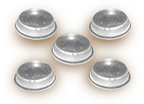

Dick, you can get these at your local Home Depot or Lowes store or similar type store
they are small rubber bumpers that go under the glass top.
Buy a bunch of them and place them every few inches apart in a straight line
they have a sticky back to them so they will stay where you put them.

Offline Dick Pacini
  • Posts: 1652
Re: How To Level A Glass Top?
« Reply #9 on: April 13, 2012, 01:34:08 AM »
Yes Walter, those are good but if the bench top has high and low spots on it, the glass will still be unsupported in spots.  I'll try it and see if I can locate them all on the same plane.

Offline builditright
  • Posts: 1043
  • So happy to be alive!
« Reply #10 on: April 13, 2012, 03:12:01 AM »
Thats probably true, then maybe you may want to fix the bench so it is flat or replace the top then these will work for you or you can place them in various spots to help assist you in compensating for the high and low spots.
