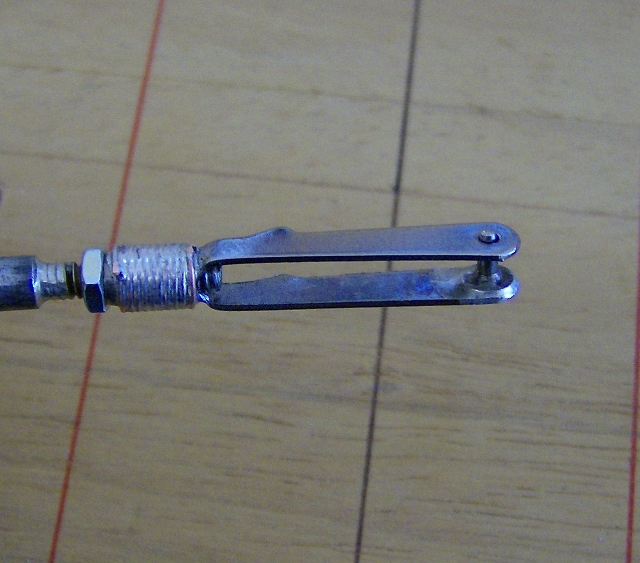

Re: What gage sheet metal for adjustable control horns.
« Reply #5 on: September 06, 2023, 10:01:12 PM »
.062 in thick steel horn, diameter .093 in music wire. Longer replacement for TF Nobler ARF. No room for ballinks, 4-40 clevis used instead.
Jerry
  I use .063 steel to make my horns and also use 4-40 links in the back of some airplanes that don`t have enough space for a ball link. I wrap some thin copper wire over the link then I apply some silver solder because I had problems with the link jumping threads and changing the airplane trim. I also make a fillet around the pin with silver solder since I heard that the pin had detached from the link and haven`t had problems.
