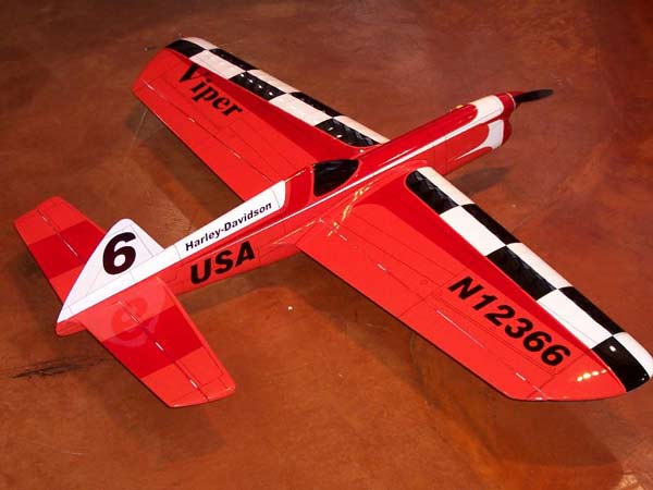

I do a airplane at Christmas vacation. My plane for the build this year is Viper 8 or V8. This is my kind of ARF. It starts life in the first picture. A pile of lumber..
Here are a few shots of the components I have been working on. I am almost ready for final assembly. The work pictured here is about a weeks worth. I should be able to get it ready for our FEB contest.
One of the nice things about being able to build so fast is I have time to experiment. This plane ( piped PA.40) should come in around 45 OZ. 650 sqs. This is going to prove to myself what I have known all along "LIGHTER IS BETTER". I am using this as an experiment to the next generation of high performance aircraft. Ron O'tool and I are working on a design the will afford light weight yet maintaining the large size plane.
I choose to use MonoKote for the speed and weight of finish. I do not like MonoKote but it looks as if is is going to be the only way to gain an advantage of weight savings.
More photos to follow this week in the building section.

Thanks for posting those Allen. I thought they were lost. Here is number 6
I might add the number four pictured above in Allen's post was built in 1 week. I had crashed the blue one above that, a week before a contest and did not have a back up, so number four came into existence. Wallah!!
Number 7 ended up in the trash can so on to number 8
