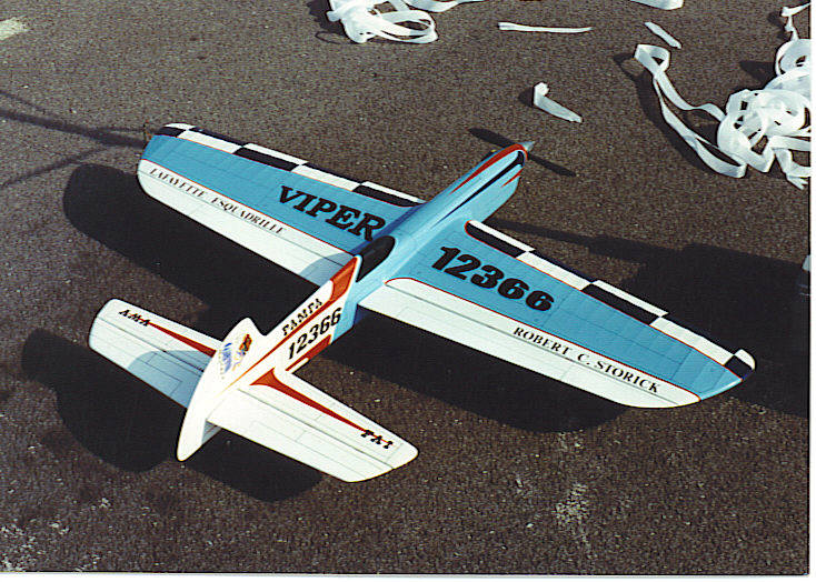

« Reply #18 on: June 16, 2009, 04:19:41 AM »
Seven was sold before flying it. Pictures are here somewhere. Pictures of number one is somewhere here also the forum is getting so big I can't find it right off.
Here is a picture of Viper 1 I found

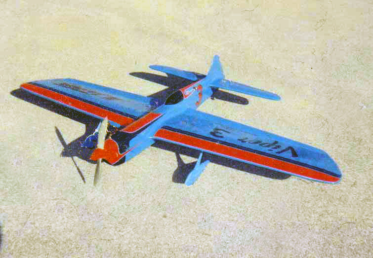

Lost Viper pics
« Reply #26 on: June 16, 2009, 05:27:14 PM »
here is a few shots I dug up.

Re: Viper 3 New lost photo
« Reply #27 on: June 16, 2009, 09:57:33 PM »
I have been cleaning my shop the last few days and tonight I found this picture. I thought there was only one pic left of number three. So it looks like old age is setting in. I have missed count on the Viper series. Number 8 should have been 11. So to simplify things no more numbers.. Besides I am done with changing things.
