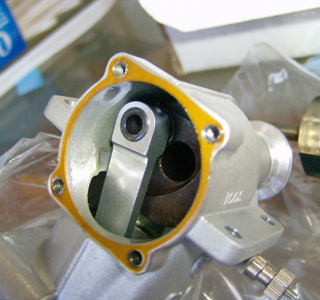

                        I have this  OS.35S and since I had heard about the conrod problem I bought 2 Rods from Mr. Neumann for it but have never used it. It has a rod with an oil hole at the 7 o`clock position on the big end. My plan was to use it on a J. Kostecky  Talon stunter but have not built one yet. here is a pics of the engine.
