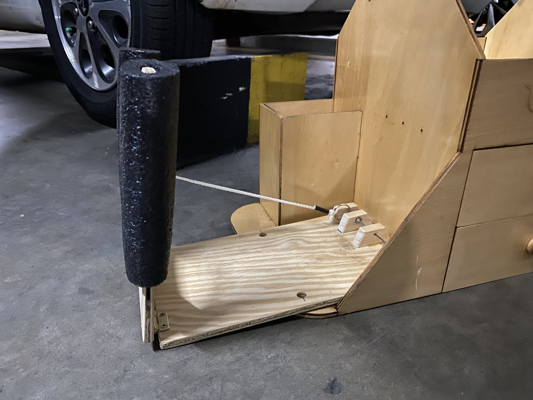

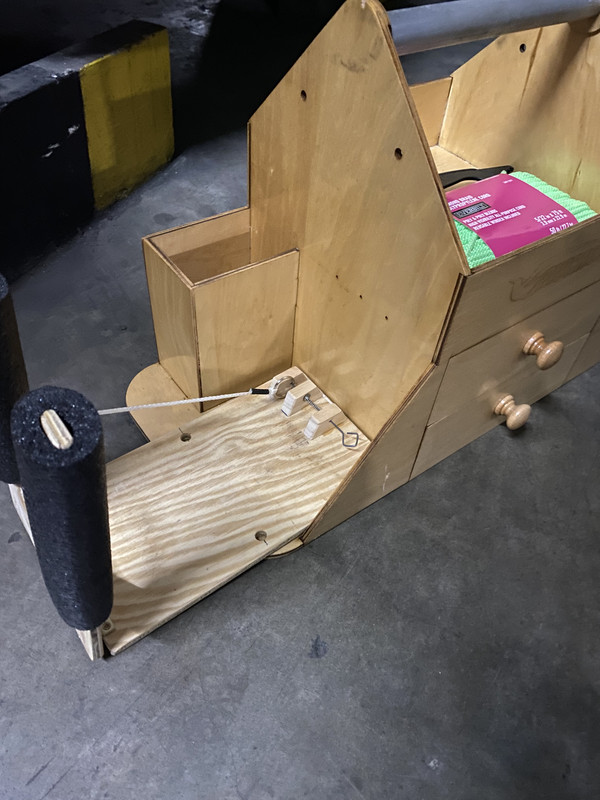

Hi it’s me again, it’s a follow up question to my previous question, still about taking-off and stooge. So please don’t get bored 😆
I still don’t know if I’m going to take off of grass or asphalt since the grass at my flying club is often tall and not trimmed regularly. It makes staking the stooge on the ground is not always the best option I have.
So I was thinking to pin down my stooge into my tool box using bolt so it’s not pinned permanently. When in use, I’ll bolt it down, when not in use, I’ll unbolt it and use the space to carry the fuel jerry can.
However, I’m not sure if this approach will make the stooge to be sturdy enough, do you have any thoughts or tips for pinning the stooge without having to pin it permanently?

Been there, Done That.
It worked just fine for me.  I had a screw on attachment for the stooge.  This Pix in 1976 so things have changed a bit.  I used a 10lb barbell weight in the box when stooging.  Two cautions - Exhaust is going to get all over the box. (Gives it character).  Second and most important it is tall enough to do some real damage if you hit it.  I launched from the edge of the circle then backed up about 10' to the center after taking off.

Hi Ken, thanks for your response.
Another thing that I’d like to know is the best screwing method that won’t crush the plywood in the long run because there will be a lot of tightening and loosening screws between the two (the stooge and the tool box).
It would be very helpful if you can provide us with some sketches as well.
Thanks!
Kafin

I used a 1" Lath screw with a 1" fender washer.  OR, you could screw some inserts into the plywood then use a butterfly bolt with the fender washer.

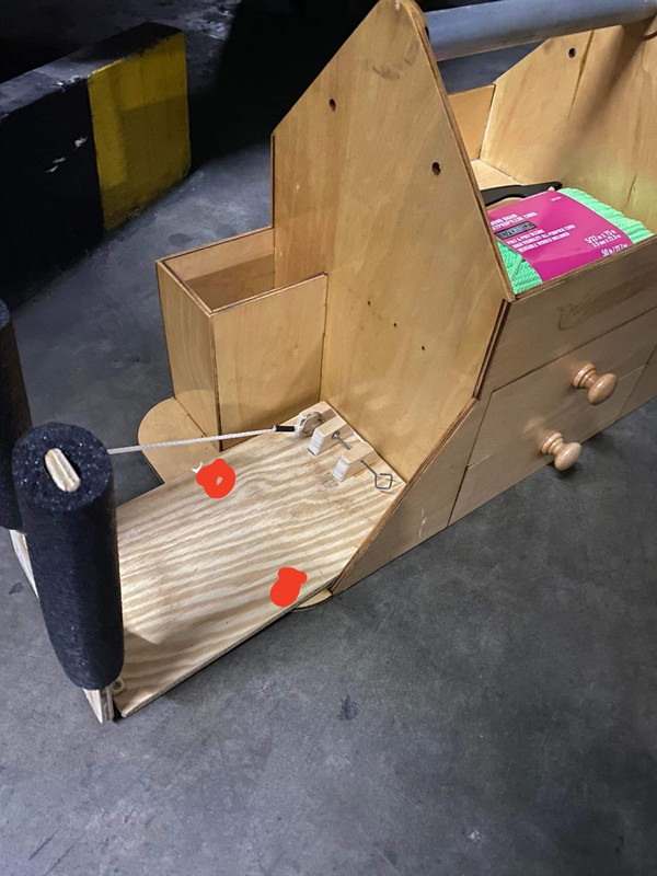

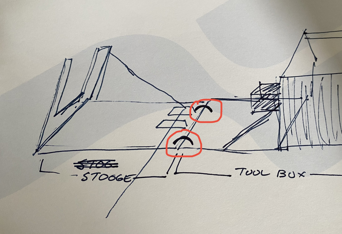

It seems that my initial plan won’t work well because the stab and the tail will hit the tool box.
So, I come up with a new idea:
“What if I move the stooge forward and connect it to the tool box by using either a cable ties or the same type of hinge on the 2 uprights?”
I will mostly fly off pavement or asphalt.
But I think I also need the flexibility to stake the stooge on the ground when the grass is in good height.
Any thoughts or comments about it?

Throw a large towel over your toolbox so that it doesn't turn into a "sugar cookie."

Seriously, I think using the toolbox is a bad idea.  Just cut another piece of plywood about 18" longer than what you have.  Screw the existing stooge, which looks fine, to it.  Put a post near the end of say 3/4" dowel and pile as many barbell weights as it takes.  25lbs will hold most anything we fly.

I found tool boxes (or flight boxes) good landing obstructions. n1 It removed the inner panel of my Ringmaster Junior's wing upon landing one time. :X  HB~>

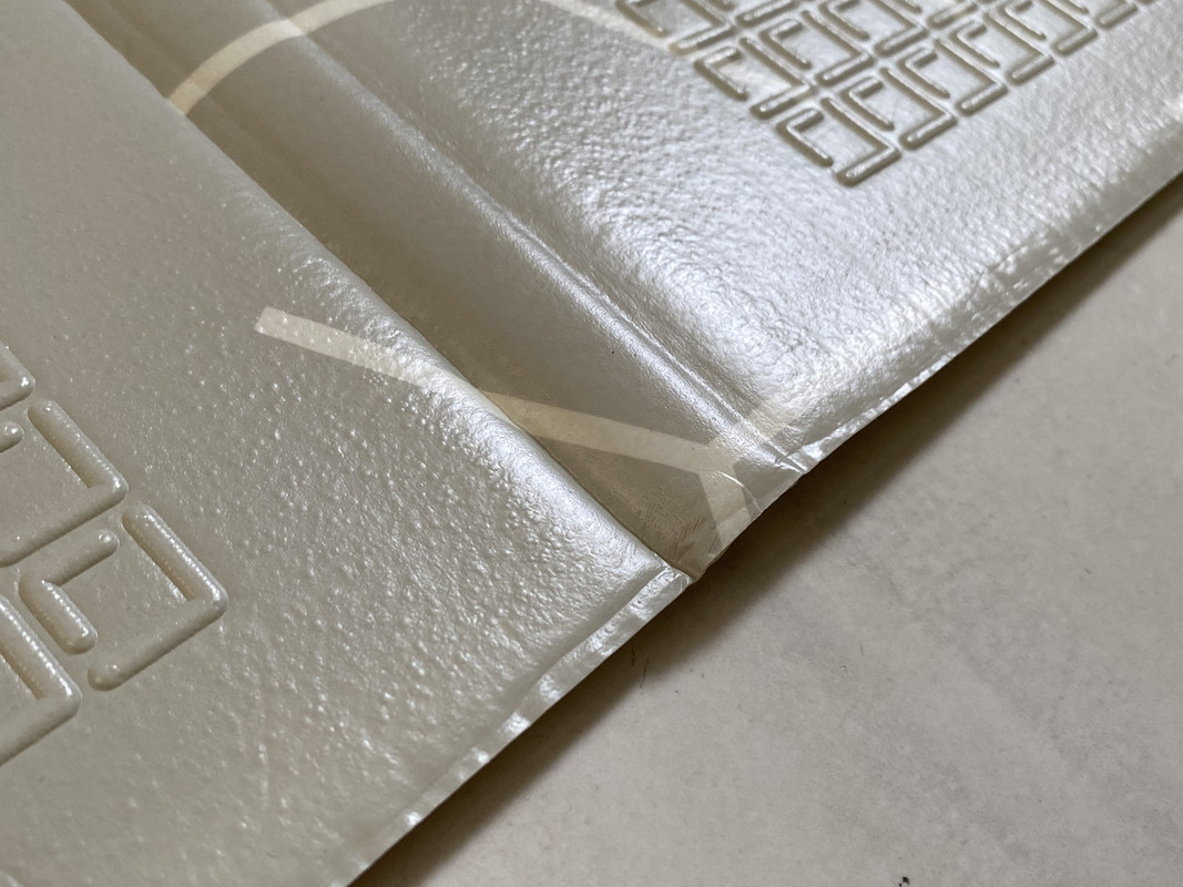

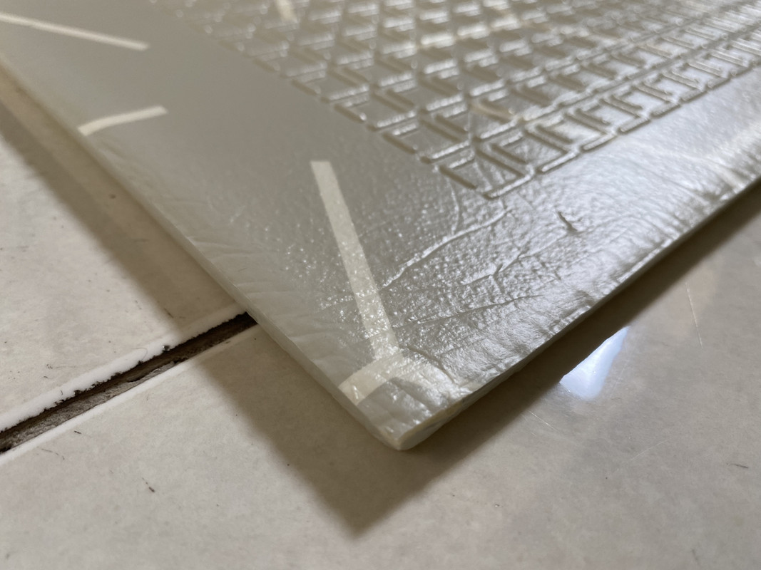

Hi, I’ve made my decision that I will go with staking my stooge in to the ground and fly off grass.
However, since the grass is not trimmed regularly that means there will be time that I have to face the tall grass, so I have been looking for portable runway options.
As of today, I have narrowed it down into two options available:
1. Runner Carpet. 100” x 30”
2.  Baby Play Mat (made of rubber and very light). 80” x 60” — I’m not sure if it will stand against the wind
Based on the information above, which one would be the better option? The longer and heavier one OR the wider and lighter one?
Looking forward to hearing your thoughts!
Best,
Kafin
