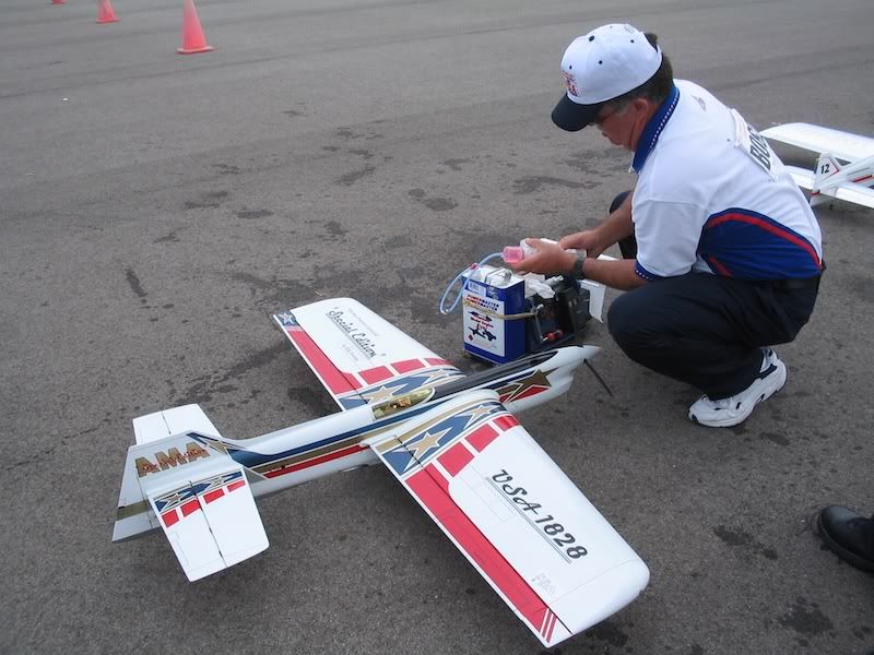

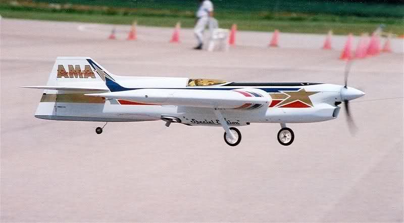

They used to say ' If it dosnt fly , put a Supre Tigre 60 in it .
Ted might have somthing to say about that .
to illustrate the subject . Tank Volume should be o.k. . But S Tigre 60 can shake , nose length / C.G. might come into it .
One can get to pedantic ( who , me ? )  Theres S T 60s & ST 60s. A good one on a three blade should cope . Not being a pipe man , myself .
Stand by for howls of derission . You should do it electric .  LL~  S?P  2 Kilo / 72 Oz. probly a comfortable weight before it'd feel the strain .
Of Couse . Theyll all tell you , you need a pipe for the wind . But if your not aiming for No 1 at the World Champs , it might not be neccesary .
Get out a crayon & see if the engine fits , with 7 ounces of juice . 60 Oz & it'd fly like a dream . A unpiped SF OS 46  is much a match for the S Tigre 60 .
I believe som,e may say a LA 46'd do it .  :-X LA Maybe , 21 46 Yes . But the word ' authoritively ' might be of some use . Ipso Facto .        H^^  Stand Clear .
Explosive Replys anticipated .
