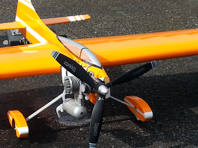

 The plane is a Sig Primary Force / flapless profile.  (Pic below)  Weights 41oz,  LO are spaced 1  1/8" apart. and the 1" was measured at the mid point between them.
On the prop.. I had an APC 11x4 that worked quite well, but its heavy. (launch rpm was 9400), and I also have used a Xoar 11x4 wood prop.  launch at about 9400rpm as well.  The Tornado is a wide blade 3-blade, so the rpm is slightly lower for about the same lap time.  I like it around 9000rpm, but I do bring it up to 9150 or so in windy conditions. ( 5.25/ lap on 61.5'  i-i)    H^^

 The Tornado prop seems to work quite well in this set up..  the biggest difference I notice is the corners are much smoother comparing to the APC.  and seems to have good line tension everywhere other then part of the RWO maneuver.. HB~>   I actually got less line tension from the Xoar.   D>K
First indication of a wimpy powered airplane or one flying too slow is loosing line tension overhead.
I don't think this is the case..  as I have good line tension on the OH-8, just part of the RWO was an issue.  Lap time was around 5.25.

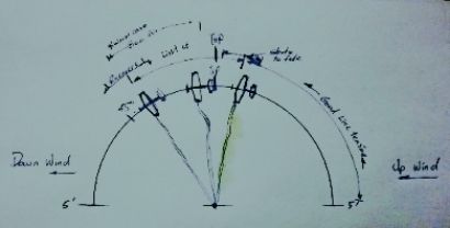

Joe,
Since I understood you to say that this occurs when the wind "kicks up", can you tell me where relative to dead up wind you enter the wingover.  If it's dead upwind or slightly past up wind this line tension problem will nearly always occur.
Enter the wingover just slightly befor dead up wind...maybe 3-5 degrees before that point and the line tension will remain much more stable.  This is a truism that I learned from Bob Whitely many years ago...try it.
Obviously this applies to tension lost when the wind is blowing.  If the situation occurs in calm air then it is another trim problem such as those discussed before.
I do have to say that your statement that the airplane is well trimmed but loses line tension really doesn't make sense to me.  Well trimmed airplanes don't lose line tension except possibly under the circumstance I mentioned above.

Re: trim queston..
« Reply #14 on: March 02, 2014, 07:23:48 PM »
It is possible that it is dead upwind or slightly passed.
much appreciate the tip..  H^^  I'll give that a try as well.
There's no problem in calm air.  The plane is quite well behaved through out the whole pattern.  :)  maybe just on the consecutive maneuvers, when the plane flys through it's own wake.. and I have to step back.
Joe....I said 3-5 degrees before dead upwind...not past!

Not sure if this makes any difference..  The Tornado prop is actually labeled as a "10x6". but it measures out to 4" at the tip,  and 5" at station 6 on the Prather guage, I put it on the plane and it performs close to a 4" pitch then a 6".
  Ah! That does make a difference, a huge one. I would say it is performing like a 10-6, by not having particularly good vertical performance.
So the 4" pitch on the APC is huge difference vs 4" pitch on the Tornado prop (both measured at the tip)? I did notice the Tornado prop is slightly undercambered.. but no phillip entry.
    I was comparing the Tornado 10-4 that you said you had to the 10-6 you actually had. We have run both props and knew what they needed to do and that's why the numbers didn't look right to Ted and me. It's a lot more like it assuming it was a 10-6, that sound like it could be in the ballpark.
    The camber makes a huge difference in the effective pitch, and the semi-symmetrical airfoil affects the measurement, at least. At the tip, particularly, the angle gauge greatly underestimates the effect of the camber.  APC vs Tornado= apples and oranges.
   By the way, don't overlook the second part of my answer above. With the prop/engine speed issue resolved, look at the rest of the trim.

9050 RPM with a 3.75 pitch prop....That seems really odd.  How long are your lines?
Typically on any of a half dozen airplanes I've flown or seen flown with prop pitches that shallow need something between 10,000  to 10,500 RPM to fly a reasonable speed.
I suspect that your engine must be really unloading in the air and picking up about 12 to 1500 RPM.
What size venturi are you running on the 46?
64 feet.
Yes, it's definitely unloading.
The venturi is, um, about that size -- it looks pretty much like others that I've seen, but with three layers of fine-mesh purple nylon net over it, 'cause that's what I needed to keep the engine from running away.  I haven't looked down it's little throat since I got the plane dialed in last spring.
I didn't know there was actually a 10-4 version.. I just went with what was measured.
Nonetheless, it also show some classic signs of yawing inboard.  At this point, even *I* would try adding a tiny bit of rudder offset and then adjusting the leadouts for minimum yaw reaction in squares, then see if it improves. I would also check that the fuselage is straight right before every flight. Profiles are absolutely notorious for not having stable alignment over environmental changes, in particular, they tend to bend like the metal thing in your wall thermostat if the Sun is on one side for any length of time. We have some unfortunate experiences with that, too.
It already has a bit of right rudder (1-2 degree), and the fuse is quite straight. The LO was adjusted with the set rudder position.  I guess I could try more rudder, but the plane flys fine as is. and has good line tension in all maneuvers other then part of the RWO in windy conditions.
      OK, Joe, I thought it didn't "fly just fine as is", hence you were asking for advice.  I don't know what to tell you at this point, this was just my best guess.
   In any case, flying of faster, or at least using less pitch at the same level flight speed, will likely improve this point in the pattern.
Glad you clarified that, Joe.  Didn't make sense if it was the Tornado 10X4 three blade.  I used the 10X6 on some of my ships but mostly use the four pitch and have started doing so on my Ruffy since I went to higher nitro, all castor fuel with a bigger intake.  The little Merco grew some balls after those changes.  I launch in the vicinity of 10K and that's where the run described by Brett comes into play.  It's strong and speed consistent.  With the 10X6 it was just too fast to fly really well at an RPM that let the engine run with any gusto.
By the way, I've absolutely loved the way the Tornadoes have flown several of my classic ships, including the smushed Nobler, the Tucker Special and the Chizler all of which had good records at the VSC and Nats events, even winning a couple.
I might repitch the prop to 3.75" but will see.
