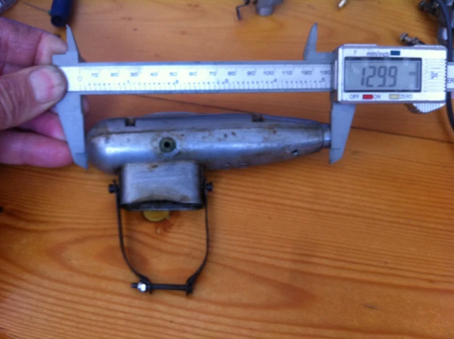

Thats the 703 , with the EXTENSION , Woter availiable for them & those Jetsreams . Or were . Note the BOLTS , and the LUGS .
Might pay to notch both bolts , side mouted undercarrageless . As you can knock out either lug , even the wind sucking it into the ground on the glide / landing .
The JETSREAM ( and THOSE ) Fit the H29R - H 40 series etc & 35C & R C derivative . So may be OUTLET BORE size differances , like on the 703
& little strap on for the 15 , 20 & 25 . ALL tailpipe bores vary to suit .
A .60 one with the straps ?
coupla pictures of a brand new .60 one . https://www.worthpoint.com/worthopedia/vintage-os-max-jetstream-muffler-60-1799853910 cant gettem on ere .

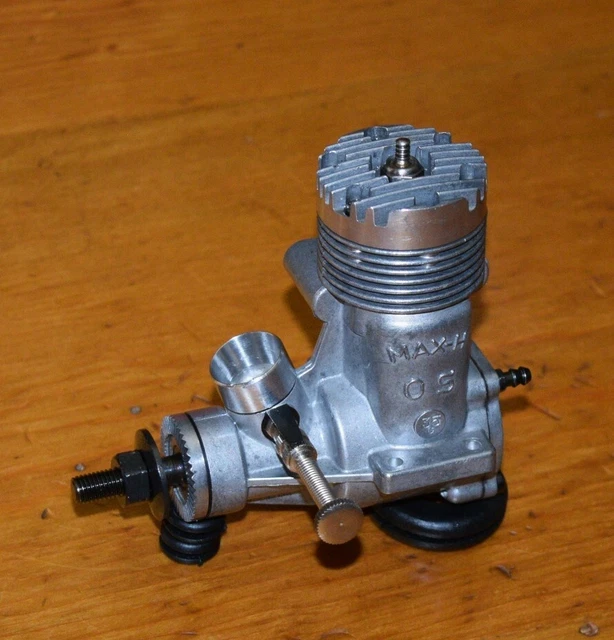

RIGHT , Model Sports in Dapto has a few NEW OS 35 S C Cases ( which are intercangeable ) the od crank , wrist pin or two Cetra . H29R & 35S runt same rod etc & P/L . According to the packets .
you need the 35 head putting a .35 P/L ineem , of couse .
Just to confuse the issue . THESE usually have C , or maybe R/C onem . Single Ball Race .
Theyre the ; back in - tapped wotsits .
And Fininanally ,  ??? You can see the little 'C'on the COMBAT , which look to have GOOD Stunt Timing .
My , what big teeth you have .  ;D Er , Intake .
oops , WITH the OS 30 S pieces . the 29R  TBR . The HEADS on the 'C '35 are WEDGE , but interchange with the HEMI 35 S heads . Keep things simple , they say .  H^^
The P/L on the ball race 35 WONT interchange , Tho Lapped Iron set up . utterly uninterchangeable .
