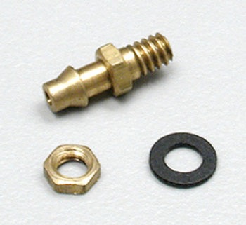

this is the Du Bro one . Had one , which was usefull , as it ' Bolted In ' a muffler . But NOTE ,
the Threads NOT right down . Tho it has a nut , so ye dinnae need to TAP the Fred . However FOR a tapped thread , Youd need a Thick Washer .
Some Stores have stocks of say OS or ST Pressure Take Off fittings to replace backplate bolts . Typically 3 m.m. thread . Needs Hole Tapping .
Theres 10.000.000 differant ones on google 'Du Bro pressure Fitting ' . So use watevers handy .
BAR some like smallis holes , not the big OS ones in their muffler fittings . ?
