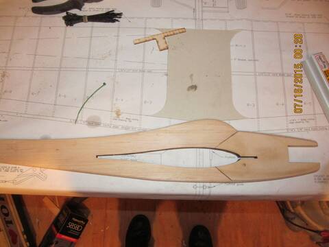

My Crash Combat designs from 1958 pictured below - wings were a sheet of plywood with something of a Clark Y airfoil on top.  As Duke Fox wrote to a friend several years ago after many complaints, "Quit worrying - go flying!".
The Reynolds numbers on our models are tiny ...
