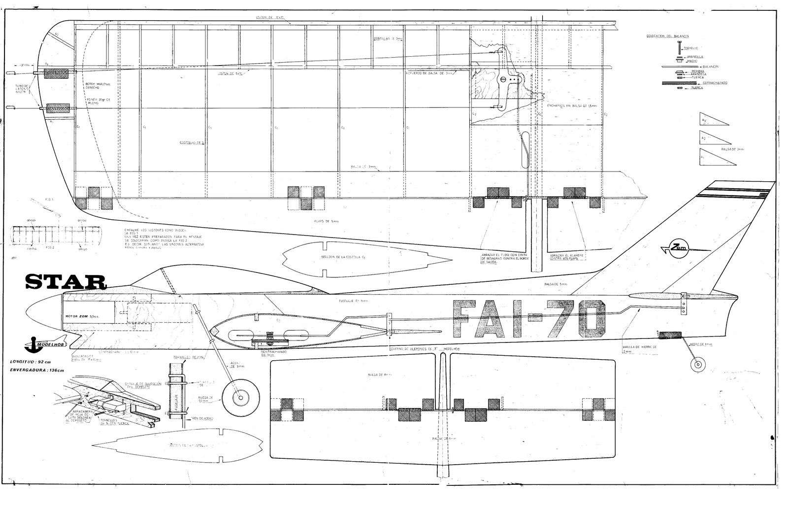

INDEED .
Looking at the 1/2 a TD etc Versions of the Spectrum , mirage , pinto etc etc , if you haf One Metre Wood There , Youd be under way - Just Add Tips - for a .15 size sleek Ace Aeroplane .
A Clunkers a differant story . Plenty of atrocious thin wing junk in English Magazines Past . :-X Most Thin Winged ' awkward ' THINGS .
A ' BASIC ' ship might be 3 foot ( sheet/ strip ) plus tips . 8 in chord , or Avg Chord . Anything much under that and its going to be a stone .
This Things Minimilist Weight , Maximalist Area , Maybe . Put the end bits so it looks like Lucille Ball .  LL~ Um , whatever you like .
Has a Sensable Rib / Airfoil .
A Oriental Rib ( 8 in ) & 36 in sheeted Le + tips , so its 40 or 44 o/a , and the notorious H C Queck mustang , FW 190 , P 40 & Zero , if real light
should do , like a slightly downzized miss BJ .
Scale to 36 in ' plank ' and leave inner flap te sq 2 Fuse .
i vill hunt for zer Queck drgs .
TWO .15s and a Oriental Wing , and it would be excellent . on hipocket . free download full size .
