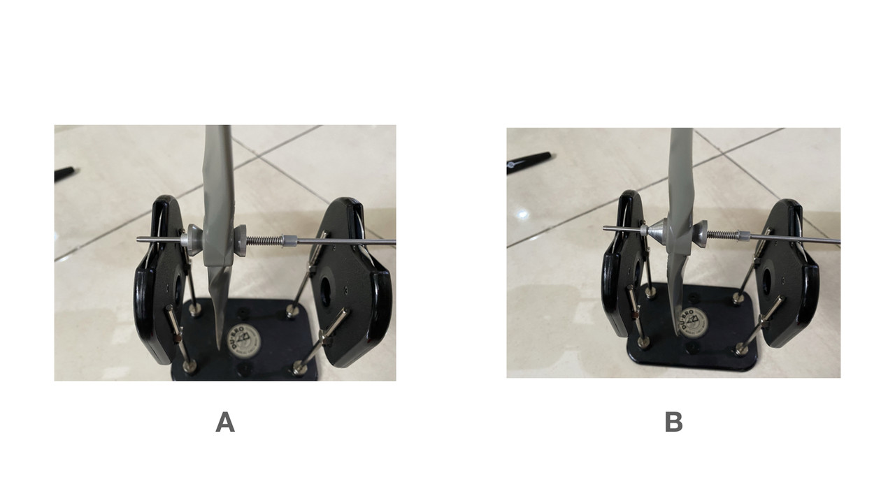

Hi, I’ve just got myself a Du-Bro Prop Balancer.
The instruction manual shows the A setup, meanwhile I’ve also seen some people doing the B setup (especially for the APC prop). I’ve tried both ways, and sometimes it gives the same result, sometimes it doesn’t. So, which one should I rely on?
Looking forward to hearing more from you!

Kafin,
Setup A is preferred, when it fits.
In general, with any balancer, you average the settings, try the prop in all four orientations, etc.  I'm going to assume you did this already.

APC themselves say the hole in the front is not reliably centered. Therefore B is preferred.

The A is intended for props.
I use B when balancing a spinner.
   Where is this stated? I have heard this repeatedly in various forums, but when we were at the APC factory, they said absolutely nothing about it, and neither do the instructions (such as they are), and there is no known factory source for the supposedly required "centering rings". Not that the idea is wrong, or that the drilled holes are sometimes off-center, but I have never heard or found any indication that they expect you to center your IC engine props using some other method than the existing hole.

On the APC website in the technical support section. There will s instructions about centering the prop on a motor shaft. It tells one to open up the center hole to clear the motor shaft and only let the prop adapter touch the shaft.

  That was the same reference as before, but it is referring to electric, not conventional props. I haven't seem nor have I ever heard of any such "centering ring" for conventional APC props.

There’s a 3/8” diameter dent in APC props that’s fairly accurate. I drill out the prop to 3/8”, then put in a spacer to center the prop on the shaft. Only then do I balance the prop. I haven’t used APCs in awhile, but when I used them, the holes were badly off center.

We are back to the same old issue:  That the molded counterbores in APC props are as accurate as their machined molds--which seem to be excellent--but that their only(?) post-molding operation of drilling the thru holes is often woefully inaccurate. I've purchased hundreds of their props and it is randomly evident in every size I can recall. Trying to balance some of these while still using the drilled hole can be futile.
So what they hope to convince you of is that this is planned, and part of their product. That the drilled holes were never intended to be used. The problem for us then is that the user must jig-align each prop to the molded-hole axis and rebore the hole and provide an accurate concentric bushing. Or, we should not expect to use the drive hub that comes with most engines but instead have one made that has a specific size pilot machined into it, as was done on the old K&B .40 engines such as the 8011. Or, we oversize the randomly drilled hole and use an accurate bushing for each installation thus making this a prop kit.
Since it is harder to rebore a hole to correct an incorrectly located hole, it would actually be better for them not to drill the hole at all. Of course, best of all would be to bring their post-mold drilling operation up the very high quality of the molded product and make all of this unnecessary.

If you read the balancing instructions you find that they apply to "all APC props".  Spacer rings are provided for electric propellers only but you can use aluminum tubing and/or fuel tubing and it is not specified that this does not apply to IC
