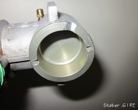

Just wondering if anyone knows how to remove the Stalker .61 back plate?  I've tried heating it and used a wedge (to fit in the two notch) along with a pair of pliers, but it just wouldn't budge.  HB~>
Thanks in advance.

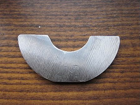

Mine did not come with a wrench either and that has been 13 years back. I made a tool of sorts with a piece of 1/8 aluminum. I made a six sided wedge from 1/8 aluminum, hack saw and a file that fits down in those two grooves and it comes apart quite easily.

The Stalkers are delivered (at least today) with a tool for this.
It is (as Ted says) very important to make this right.
The tool is a half of a circle D shaped steel or other hard metal plate.
Thickness the same as the notches.
It's diameter is 50 mm (or very close to 2").
You put the tool in by placing the ROUND part of the plate pointing towards the backplate.
You can actually see that the notches are made for a round rather than a flat plate.
Also note that the head bolts of the Stalker are also metric. If you need to remove the top , use a 2.5 mm UMBRACO wrench.
Best regards Norvald.

This is similar to what PAW does. I ordered the "tool" for backplate removal. It was a small piece of steel curved on one side, the other side goes in a vice. I clamped the "tool" in the vice, curved side up, and seated the backplate onto the "tool". I then turned the engine to remove the backplate.
