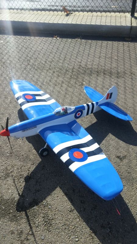

Theres a plethoria of drivle on SPITFIRES here ; https://stunthanger.com/smf/nostalgia-30/mark-freeman's-spitfire/msg491962/#msg491962
Inc. pictures & video of Dave wrights 110 % Freeman - Stalker 60 ? job . ( Curve on Freemans fuse. is a over k , hence detail drgs/ there .
the Urtnowski / Adamusko  ' 90 ' Spitfire , is about the size of a Pattern Master . Uses that AIRFOIL . Identical to my 63 span G - 51 in planform , Bar hinge lines further aft by 5/8 "
THUS , with my revised flaps & clipped tips , gets 60 span , & easy adjustable leadouts . Theres a few ' Round Tip ' ( Speed Spitfire ) shorter span , and Long ( pointy ) tip ones also .
All the Fuselages are cr*p but mine . !  S?P LL~ which is Tough as old boots, light , scale bar 1/2 deeper at rudder post , so rear undersides not so angled up .
Got drawings for the Merlin & Griffon versions, and a canopy mould . Find a lot of canopies so unscale its painfull .
And watch out for those leadout guides : :-X
Think might be ' post ' not ' pre ' event .But substantial adheshive for substantial restraint , perhaps . not ' a drop ' of super glue ' .
' 90 ' wing plan , liberated from Stuka . Stunt . Mr Downeys work .
« Last Edit: February 10, 2020, 08:00:09 PM by Air Ministry . »

Fuse is longitudeinal strips , beveled edges . about 11 Oz complete with tail , etc . if you remove the wing , after the elevator disconects inverted out of a wingover at top whack ! .  :-X
on a predecesor .
This wings Urtnowskis is identical to . The 90 Version . EXCEPT this is a SV  ish airfoil , stated cords not increased . The Flaps toon in without the previous inner narrowness ,
after years of cunning & studied viewing !
the ' 90 ' wing , with the leadouts exiting at the underside of the rib , at the end of the flaps, there . Will get more realistic diheadral . Bellcrank up in top of wing- under spar joiner- mount.
Bit of a p.i.a. to get it all in and free , but you can relax when its done .
Definately lucky boxes rather than ' through horn ' . Perhaps .
ST 60 in this . 63 span . No Worries . Removeable landing gear . Technically Mk 10 or Mk 11 Photo recon job .
This isnt.
You can see the strip fuse construction here : https://stunthanger.com/smf/open-forum/meanwhile-back-at-the-ranch/msg397797/#msg397797
Essentially 1/4 sides , with a scour line along thust line , glue in then kinked. Beveled edged strip over & under near 45 to vertical . 1/2 strip top & bottom .
Or a few fancy bits for bubble top .
This Mates to the ' 90 ' P M Airfoil Wing No worries . Will chuck a picture on of the Long Griffon Eng. High back fuse . to suit Tomorrow .
That'd give you essentially THIS . Rolls Royces own very aeroplane. Course any clip wing versions easiest . The extra chord makes the tips oversize, on the ' 90 ' if elliptical .  :(
Gotta set of the Laser Cut ribs for that, so there out there. Draftsmans name is on 90 plan .
the irregular rib , halfway out the flap tab , is where you ' whack on ' the ' clipped tips ' .
that chord / planform , + 5/8 " and youve got the ' 90 ' wing planform .
So clipped tips is the best way to fudge it .
You could go up from 3 " to 4 " on the flaps , without it being to obvious .
your pictures likely a Mk 14 .
' Spitfire Walkaround ' will give you good shots for silly details ' . Or the CORRECT shapes , too .

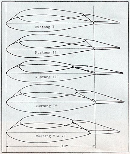

If you were keen to do a ' Spitfire 4 "  the airfoil development went ,
https://www.airplanesandrockets.com/airplanes/images2/sea-fury-al-rabe-aam-march-1973-12.jpg
https://stunthanger.com/images/airfoils.jpg
The Last , " Mustang 5 " Airfoil , carried 5 ton on the Martin Baker M B 3 , or 2 Kilo anyway . at 51 inch span !
Very consistant bottoms despite the pilot . So building in some extra strength , youve got the power to haul it .
With a 4 " bellcrank , it should have the CONTROL AUTHORITY , which is the 1st prerequiette .

As you said your keen on the ' bubble canopy ' version , Heres a Adamusko 90 version .
Thats presumeably a Seafire 17 . Which is almost a Spitfire 16 with a ' short ' ( Single Stage Supercharger  ) dropped in . So is a Mk XII ( First production Griffon version ) derivative .  :P
Like I said , that wings identical , bar 5/8 aft hinge line , to the blue / Stripes one . Scale Approach gets the divergent taper flaps . First 6 inches straight / parrallel to hinge .

Beat Ya !  VD~ LL~ S?P Though iit IS Skips PICTURE , Via anuther site ,
Be intrested in Joe's evaluation of the ' wide chord outside prop disc ' flaps , As He has flown them a lot . Suggests He might not be unhappy with this set up ? .
can be seen airborn on several ' Windy U Master ' tapes . inc. Joes initial flights of one of his .  H^^
Thanks Skip . Got a bit of a jump when I saw it there . Got any others of it, thanks .
