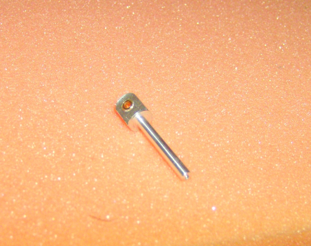

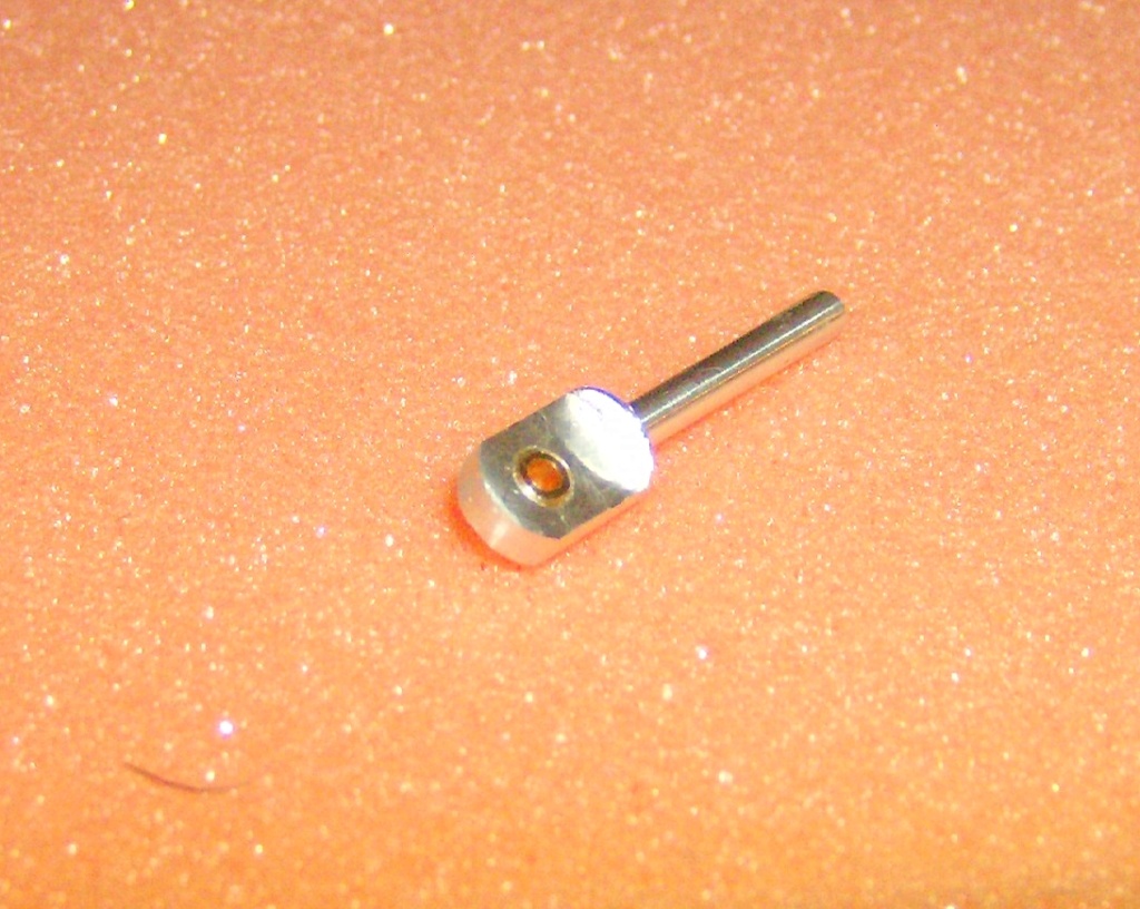

Re: Small Aluminum Tubing
« Reply #9 on: October 10, 2023, 05:06:47 PM »
 Hello Ken
                     Thanks for posting the link to Storick`s excelent tutorial on how he does the hinges. He doesn`t mention what material he used to make them My guess is that they look like plywood but the video is blurry and I can`t be certain. I have seen that type of hinges on the Yatsenko Classic that a friend had. They were made out of plastic. I tried my hand at making something similar using a .250  6061 aluminum rod and made this one today. I think it will work using some .065 stainless steel wire for the hinge pin to avoid corrosion.  I inset a small brass bushing pressed in place to help with wear and it came out weighting less than a gram on my scale which only goes to one gram.
