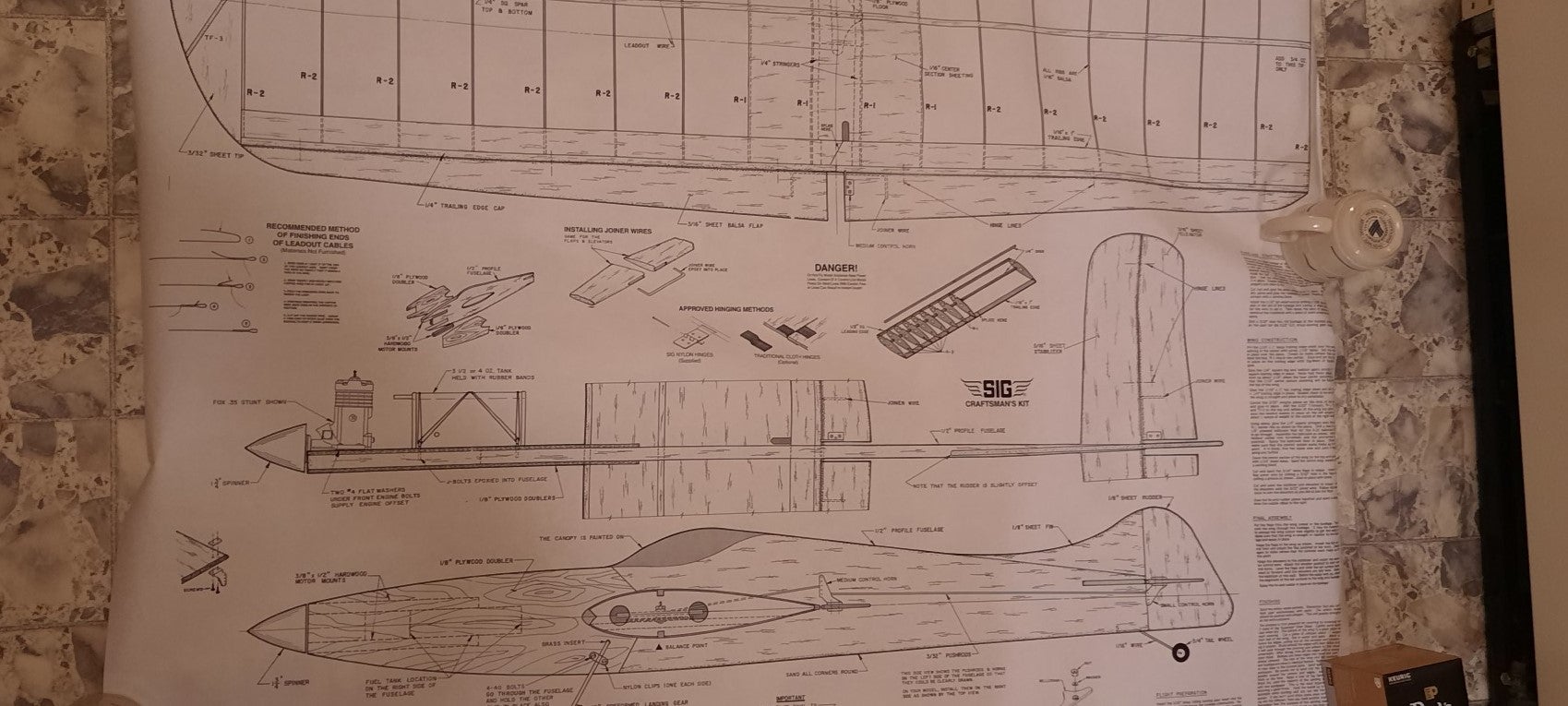

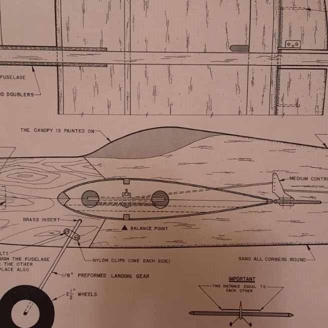

I was given a modified Banshee that looks like a Ryan ST. The previous builder did a good job changing the out line of the fuse and tail. The engine spacing is for a Fox .35 stunt. He glued on the flaps but look rather short. I don't have the plans and was needing the measurement from the end of nose to front of L.E. also what is the width of the flaps next to the fuselage? I plan on adding working flaps again.Thanks!

The stock length of the schnazzola on the SIG Banshee is 9-3/4" from wing LE to the end of the engine bearers. The root chord on the flapparrooni's is about 1-15/16" also scaled from the plans. The flaps are full-length but the tips are blended into the rounded wingtip planform.

one of the posts says move the wing forward 1 inch , ad 1 inch to each side of the tailplane & elevator . or https://stunthanger.com/smf/open-forum/big-jim's-plane-was-it-the-first-one/msg54385/#msg54385
Let me tell you about the pink Banshee.
1)   54” span equal panels
2)   Half ribs to spar with vertical webbing between spars
3)   Adjustable Tip weight box and movable leadouts
4)   Flat wing tips
5)   8 1/4” nose
6)   ¼” stab and elevator tapered to tips 261/2” span
7)   Diamond shaped Fuselage with the top and bottom end 1/8” thick
8)   Barn door flaps 2 ½” to 1 ¾”
https://www.rcgroups.com/forums/showthread.php?3997575-SIG-Banshee-Rebuild
