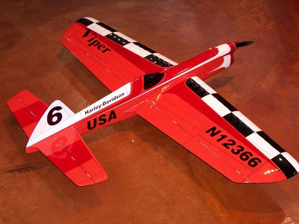

I had set out to make my world beater this year in the 40tys. The Viper has been a long project of refinements. The first one being 41 oz with a FP .40. Flew rather well however it would never had enough drive for the high winds at the NATS. My favorite on was the Super glide at 50 oz but was still powered by a FP .40 on a pipe. A string of Vipers were built using different power configurations including Super-tiger big blocks.
 My disappointment has always fallen in the concentrated weight in the nose. The tug feeling you get coming over the top is this thing going to turn. This feeling is prevalent in my larger ships.
 So Viper 8 started out as a pipped PA.40UL ship. Clean yet sparse on Clear to keep the weight down. 47.5 OZ.The first test flight showed great promise. The were a few trim problems. Seemed the outboard wing had a slight warp in it. SO the flaps were tweaked to get it to fly level. This caused the butt to set. Always looking for groove. So after 10 flights on this plane I knew in my mind do things would have to make plane more positive. After landing on the 10th flight I conferred with Ron O'tool what I had in mind.
 He arrived at my house to Find the tea kettle already steaming .We steamed the wing straight and reset the flaps to neutral. First problem solved. I knew I wanted more drive for the wind so I opted for the PA.65. After careful assessment and fitting I got it into the tight confines of the .40 size plane. Refitting the larger pipe and 8 oz tank.
 A trip out to the field for 10 more flights to see what can be learned. All trim was left the same. Lead-out placement, WT weight etc. I was a little apprehensive at the nose heaviness of this airplane. At 2.5 inches it was extreme. 4 flights were made with no trim change. Directional stability was at its utmost (nose-heavy) and the turn was diminished somewhat. It was hinging in the turn. So lead-outs came foreword 3/8 of a inch. It got much better in the turn and set. Around the 15th flight we decide to add some tail weight. Approx 1 oz of solder was added to the tail wheel wire. WOW what a difference. No hinging and the turn was again like lightning. The CG moved to 2.75 from LE. I have great directional stability and lightning turn. I don't know Doodley squat about pi times radius squared and the alpha numbers but when you see this airplane fly you will know what I say is true. Its all set in weight!
I will remove the solder from the tail wheel and shoot some more clear on it to move the CG to where it is at now.I have also ordered a MAG spinner, back plate and drive washer to reduce the weight in the nose. Target weight now is 52 OZ.
You have to ask yourself why did he opt for the .65 if he's worried about weight? Propeller my friends.. I am now turning a 13.5 under cambered Phelps propeller for massive drive in the wind. The winds at the NATS are generally 15 to 20 MPH and not called off till it reaches sustained 25 MPH. I wanted the positive drive of the larger propeller for the only contest that this plane really was designed for.
 Oh by the way Viper 1.0 is now under construction for the PA.75 Numbers will be 60 inch span, .8.25 nose 17.5 tail target weight is 55 OZ. You ask why the .75? 15 inch prop.
Try to remember I am a mechanic and learn by doing. If you don't believe my results on weight try it for your self. Its not as easy as it sounds to get the airframes this light and still be structurally sound. But if you can you will realize the pay off and never look back again.

Online RC Storick
  • Posts: 12573
Re: Set in weight, A Viper report
« Reply #30 on: March 24, 2009, 10:52:15 PM »
I dont follow.  You have always said, and I am paraphrasing here, that weight is of the utmost importance.  Right?
Then you added 4.5 oz of weight to your plane and it flew better.  Yeah the motor is bigger but that does not change the simple fact that you are flying a heavier plane.  It now has MORE wing loading.
It appears to me that the opposite is coming out.
Also, as many have said over the years myself included, a good strong motor run is the most important thing.  You are proving that without a doubt.  You put in more usable power in your plane while adding 4.5 oz and it flew better.
If you really want to prove the weight theory once and for all you have to build a plane with a ballast box on it..  Build it super light, no finish just clear fuel proof dope.  Then add and remove weight in the box, located on the CG of course, and see where it really flies best.  Even then nothing has really been proven because the weight that is added and removed is concentrated in one area......and the discussion continues....
You are obviously talking hypothetic as you have not done it.
Once again you have missed the point. It does not fly better It has more power! You guys are always trying to goat me into a argument you can not win! Start your own thread.
And to Brett I am from the SHOW ME STATE so your going to build a light one now right? Oh ya don't forget to add the ballast in the belly.

Online RC Storick
  • Posts: 12573
« Reply #32 on: March 24, 2009, 11:44:32 PM »
    Uh, Sparky, I was building 630-640 square inch airplanes in the low 40s with ST46s - and flying legitimate 500 point patterns - 25 years ago. In fact all but one of my ST46 airplanes was in the 40's.  But why would I spend the time to build something uncompetitive just to show you I could do it?  There's no great skill associated with building light, nor does it significantly improve contest results.  RS: (Please tell this to Billy W and get his response) Believing otherwise with religious fervor doesn't bother me too much, but it also doesn't make it true.
    And I still haven't seen your explanation as to why adding 8 full ounces of dead weight to a 40-oz Tucker special made it fly so much better. Or maybe you think Ted Fancher and I either don't know how to trim, or can't tell whether it flies better or not? Also, why did the lightest wing loading to win at the NATs in the past 20+ years was around 13 oz/square foot. RS: I would think winning the world is a better acheivement. 2004 Razor back 53 oz 700 SQ whats the wing loading?
Here is my thoughts. Just because you say so don't make it right. Ron O'tool will be at the NATS this year tell it to him and get his response. Also to build planes back then that light was not as difficult as it is now. Wood availability. Please send me that 4 LB stuff seeing as you don't need it. I will pay 2 or 3 times what you paid for it.
Just because a guy has all the time in the world to practice to fly a model airplane does this make him a smarter /better person than lets say the 40th place guy. Does this make him a better builder? No it makes him a better flier. After not agreeing with all of what Wild Bill has to say I had to re read his stuff which everyone seems to hold a gospel. But I am not sure people understand what he wrote.  I gave the page number on his writings heres a web site. http://www.iroquois.free-online.co.uk/netze/wildbill.htm
His writings in stunt news have a different flavor. Lets give a for instance. His writing state the BC should be just behind the CG? (does it matter?) in the next breath he says for a sluggish airplane move the cg back? But now the BC is in front of the CG (unless you have that mystery floating BC). What happens when the BC is in front of the CG? encase some don't understand Line tension is diminished. (but it don't matter).
Congrats on winning the NATS thats a achievement I hope to do someday. But to talk down to me come on.. Ain't happening.

Viper 8 is a approx 650 SQ in wing and a 9.5 nose and 16.5 tail. Now with the .65 in the nose it weighs 52 oz. The turn diminished somewhat from the original .40 at 47.5. It did yaw at first but after moving lead outs foreword 3/8 of a inch this went away. I am using a 13.5 prop and after adding a 1/2 of tail weigh the turn is specular. I have ordered MAG parts for the engine to reduce concentrated weight in the nose. I have always said the base line characteristic is set in weight and this experiment proves it.
Viper 1.0 will have a 8.5 inch nose and a 17.5 tail with the 75 in it. Pulling the weight back helps but does not get totally rid of the base line I speak of. Before anyone comes back to dispute this Build one of your own for this experiment. Using the same plane but with different engines.
So what airfoil / wing thickness are you using on these current Vipers ?
Allan Perret
AMA 302406
Slidell, Louisiana
Online RC Storick
  • Posts: 12573
« Reply #40 on: March 26, 2009, 07:14:06 AM »
root is 2.5 X 10.5 tip is 1.75 X 7.5 Generic airfoil
