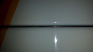

Hi Perry,   Thanks for the detailed illustrations. that's an interesting way of doing it.. will have to look into it.  I think the problem is the flap/ wing hinge line is fairly close together,  and also it has a 40 degree or so bevel flap edge to straight trailing edge hinge line, which makes the angle even sharper for the tape. (pic#1)  On my other plane with more typical hinge line (pic#2) and 1/16"or so gap works just fine with either Dollar store/ Crystal clear or 3M Multitask tape.   The problem is there isn't enough room for the tape to flex.
Pic #1
Pic#2

   If it is too stiff, then you didn't get it all the way to the hinge line. If it crosses the gap in line with the hinge pin, you are just flexing the tape, which is negligible. If not (which is how yours is), then it has to roll the tape up down. I can't tell if that is the problem because your pictures are too small and not enlargeable.
     For future work, leave a gap sufficient to make it easier. I use a single hinge pin (and idea I ripped off from Paul), and in that case, you can (and must) have the tape touching the pin, which makes it a snap to apply the seals.
   To your original question, yes, you can do partial seals and/or not seal over the hinges. It's not a good idea, generally, but you can certainly do it.
That is probably what is going on, as there is not much of a gap in between the flaps and the wing.
I don't think the hinge line on this particular plane could be sealed with the conventional way method without getting stiff and springy controls, as there is near no gap.. but doing it partially inboard or outboard isn't as bad.  Just curious which is more effective. (sealing only inboard or outboard?)
