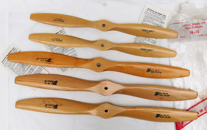

You can see , if you Cut Down these , all to the same Length / Diameter , theyed all be a bit differant . No matter what the pitch .
https://www.etsy.com/uk/listing/1273973884/maple-wood-propellers-top-flite-super-m?dd_referrer=https%3A%2F%2Fwww.google.com%2F
thus & therefore , if you THEN , made them all the same THICKNESS , theyed ' turn ' more alike . Shaveing T E's thin - altering high point , fore or aft .
Leading Edge radius , and hight ( Philips entry , more airfoiled forward - or Low & Sharp - ( or high & sharp ) ) Sharps only to unload motor  , perhaps .
