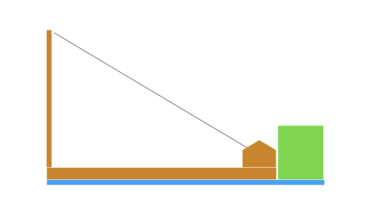

« Reply #28 on: November 14, 2022, 04:34:40 AM »
Hi all,
I have just recieved this stooge.
My flying field is asphalt, so I don’t have option to stake it to the ground.
I’m thinking to bolt this stooge into a 1/16” stainless steel plate that is slightly wider than the plywood base (this is indicated by the blue marking) — the plate will add weight for about 5.3 lbs.
Beside the steel plate as the base, I would also add a steel block behind the release mechanism (this is indicated by the green marking) — the block will add weight for about 12 lbs.
Top View:
Side View:
Will it be sturdy enough to hold:
- Cardinal / Pathfinder with ENYA SS40 S
- Vector with ENYA 35X S
Any thoughts on this idea?
Looking forward to hearing more from you!
Best,
Kafin

Mine had a much larger 1/4" plate.  Very heavy.  Your design using the goal posts, you could easily put a 5-10 lb barbell weight in the center or some lead sheet if you can find it.  I have done that on the loop/pin ones as well.
I was also thinking about putting a barbell weight on the top-center of the plywood base, but then I’m not sure if the plywood will be able to hold the extra weight (15-20lbs) on the top of it.
Will the plywood be able to hold the weight?
That’s why I was thinking of adding a reinforcement steel base beneath the plywood before adding more weight either on top of the plywood or the steel base like I mentioned.
  • Posts: 7042
Re: Stooge on Asphalt?
« Reply #31 on: November 14, 2022, 07:59:09 AM »
If you are strictly on asphalt, you don't need it, but it can't hurt.  If you are going to add a thin metal base, why not make it a foot longer in the back.  You can pile as many weights as you need on it and not touch the trip wire.
  • Posts: 7493
« Reply #32 on: November 14, 2022, 08:18:27 AM »
  You are not only worried about how the model pulls against the uprights, you are concerned with how much pull there is when you pull the release and it doesn't move the stooge. This looks pretty much exactly like my stooge. I have mine built onto a 3/8" thick steel plate that weighs about 25 pounds, maybe more. That may seem overkill to some people but I fly .60 size models also and they can pull like a tractor. And it's only one thing to have to load up and carry.  You may notice that Brodak or some one else sells a stooge that is built on a piece of 3/8" plate. It just doesn't leave anything to chance. I also have some soft rubber sheet on the bottom for added traction in case the pavement is a bit pebbly or damp and is slick. You may have to hunt around some scrap yards or similar places to find apiece big enough for your needs and it won't be to cheap, but it's well worth the effort and cost for the security and piece of mind that your model will stay put when you start it. Once you get your set up all assembled and ready to use, test it. Rig something up to pull on it like a model and give it a pull test just like you should be doing to your airplanes. Also test how the release line pulls and whether it moves or not. The release like is pulling from a different angle. Look it all over and try to see ANY way that ANYTHING  might possibly fail. Again, this is well worth the time invested for the security and peace of mind. There are just lots of ways that things can and will go wrong, and a run away model can cause a lot of physical harm and damage. You have to respect that spinning prop no matter what size airplane and power plant it is.
