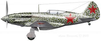

mixed feelings between the white/red or the colorful Rumanian
i´ve seen 2 of these migs already done with the white/red....maybe i´ll go for Rumania for a change

Not that it matters a rats snot , But the Rivet Counters after innumerable cups of tea , spectron anaylisis , bickering & other nonsense ,
Decided that they were replacement outer wing panels , thus GREEN - ish .
Seeing thisis so big & hairy , I will put it on .
Looks like someone found some Gloss Clear .

                  I would like to suggest this two paint jobs. I would not ad any weathering and give it a very glossy finish.
