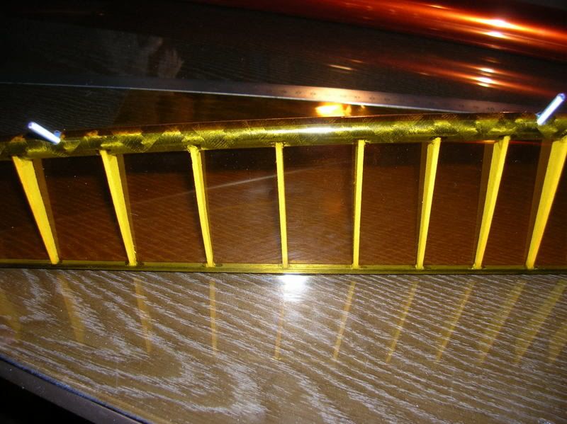

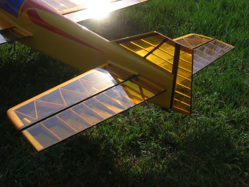

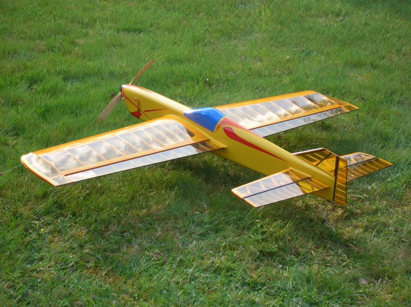

While looking at this picture of Richard Kornemeier's (edit: Frank Wadle, sorry... not Richard Kornemeier!) model at the World Champs I noticed that the ribs are closer together near the fuselage. It's the same on the wing, flaps, stabiliser and elevators.
Presumably the intent of that is to distribute the strength and structure to where the loads are higher. The thing is, I'm not sure if it is actually doing anything in this case. The ribs hold the skin out and take the pressure on the surface, but they don't have much to do with bending loads and torsional loads compared to the LE sheeting and spars.
At first look I thought it was a great idea, but at second look I think a better idea would be to have the ribs evenly spaced and taper the sheeting and spars (in thickness and/or width, whatever suits the structure best). He may well have done that too, but we can't tell from this picture.
So, is there much point in having more ribs in the middle and more space at the tips? Does the pressure distribution on the skin really require more support in the middle?
« Last Edit: November 13, 2011, 04:37:42 PM by ash »

dunno - but his flap structure looks pretty fricken light!!!

Nice looking model from that view.  "Flite Streak" type wing tips.
I'm working on a wing now that has tapered sheeting, tapered spar also. May not be anything to it, but it sure looks good!  n~

« Reply #3 on: November 13, 2011, 04:18:40 PM »
 Hi.
 That's not Richie but Frank Wadle.
 We do the same thing with rib spacing in Free flight, plus that I reinforce the about 10 rootmost ribs sides with +-45 degr. glassfiber. The root ribs are usually the first thing that fails in a strong launch; High tension in towline (up to 30kp) bends wingtips up, and that causes the t.e. to compress against the ribs. At some point the carbon capstrips collapse and the model becomes unflyable.
 I cannot see why the same mechanism would not apply to a stunt wing. Of course, the wing is not thin & undercamber but the amount of stress the wing must handle is about the same.
 And Franks flaps are the stiffest I've ever seen! Very cool torque tubes. Lauri

What cannot be seen from this photo is if there is any use of Shear Web between the ribs.

I'm inclined to agree that it doesn't make much sense as a structural feature. But it looks very good!
Appearance is a worthwhile reason for doing it. It's a nice looking model.

By supporting the sheeted LE with closer rib spacing, the strength and stiffness near the center of the wing would be improved, and wider spacing at the tips would save weight and reduce weight at the tips, which I think is a valid design goal.
FWIW, one clever guy I read about in SN curved his fuselage sides to improve the stiffness...that would be Larry Cunningham. Personally, I think the uneven rib spacing looks flaky, but this is obviously for F2B, so no appearance point issues.   H^^ Steve

Personally, I differ with you. When a wing breaks from load abuse, it generally happens in the center portion of the wing simply because that is where the load is manifested. In the older airliners - the ones that I flew - there were limitations on distributing wing fuel so as to keep fuel in the outboard tanks so as to not allow the wing to bend upwards too much during flight. In the OLLDD USAF, the B-47 did not have in-wing fuel so the bending of the wing was allowed up to 27 ft at the wing tip. After that it probably would desert the airplane. During LABS maneuvers - a system to come off the deck and toss a Nuke at about 18,000 ft - a number of airplanes did shed a wing and that was at the fuselage. Kinda messes up your plans for later in the day. Once they rebuilt the wing mounting, we quit doing that maneuver because the Thermo Nukes required better distance procedures.
I have often wondered why CL Stunt designs did not build stronger structures inboard and lighter at the outer 1/3rd +/-. Maybe it's just that the guy won the last contest with XXXX therefore my new design will be like that one, syndrome.
I think that design pictured is way ahead of the average stunter. Those carbon tubes are very stiff.
Look closely and a thin strip of rib is under the capstrip, top and bottom. Then looking at the inner core under the spars, one can see what looks like the rib becoming solid forward. In addition sheer webs may do better for preventing wing twist, however for bending under load, a 1/16 -3/32 X 1/2 against ribs or so will do as well as a complete section between ribs. Worked for me in C FF, CL stunters, Q-500 Pylon and Scale Warbird Racing.

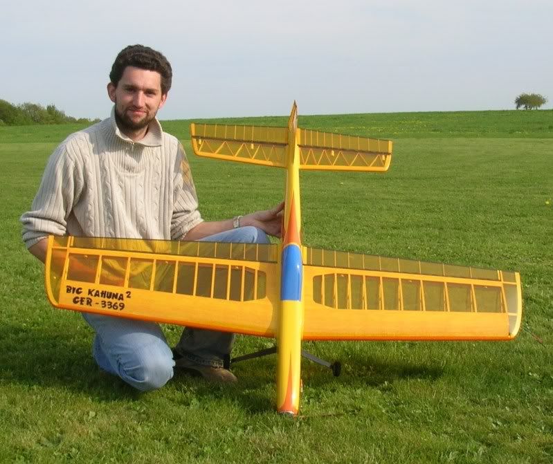

Here's a different angle.
(photo from Claudia Kehnen's gallery on flickr)
http://www.flickr.com/photos/fesselflug/sets/72157604344596607/with/2379408497/

By closing up the rib spacing as you get nearer to the fuselage sides does do at least one thing that is favorable as I see it. By making the unsupported length of the spars shorter between the supports, (ribs) helps control the flex possible in the unsupported span. Coupled with the truss style webbing will make the center section of the wing much stronger, where it's needed. Out, as you approach the tips, the load isn't concentrated, so there's less tendency to flex.
I once applied a strip of CF to the top side of the spar. Not a good idea. The spars flexed enough that the glue bond between the CF and the spar failed. This made for a noticably weakened wing. I later found that in such cases, the CF should be lamionated between two pieces of spar material. H^^

Do I see carbon footprints in some areas?
I'd like to know more about his use of carbon. That can't be just black paint?
Great craftsmanship for sure!

   And, the right answer is, closer rib spacing helps *marginally* by providing more stability to the wing covering and LE sheeting to reduce the chances of it buckling when in compression. But is almost certainly much less effective (in terms of added strength VS added weight) than a lot of the other items mentioned, like beefing up the spars near the root, make the sheeting thicker (or double-covering, although that has other issues), etc, that put the extra weight near the wing surface.
   If you were to taper the LE sheeting from maybe 3/16" at the root to 1/32" a the tip, for example, that would likely be a much more efficient use of materials for a given weight, at least to mitigate flight loads. Howard could even figure out what the thickness profile should be as a function of the span, if he were so inclined. It might be impractical but it's a useful thought experiment.

Hello everybody!
First I would like to thank everybody for your positive feedback on my plane!
After reading this thread about one of my planes, I thought it would be time to register to this forum and comment some things discussed.
The first picture in this thread shows me an my Plane "Big Kahuna 1" (BK!) at the EC 2011 in Poland.
This plane was the second "serious" stunter that I've built. The build of this model was covered in a thread at the German forum (see link above).
Two years after BK1 I started to build an improved version "Big Kahuna 2" (BK2). Modifications included (but were not limited to) more strength and stiffness by using more carbon fiber. Both planes BK1 and BK2 were used at the 2009 EC, 2010 WC and 2011 EC and will most likely be used next year for the 2012 WC.

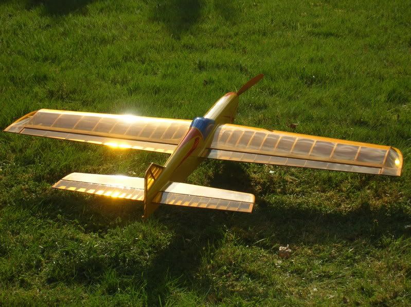

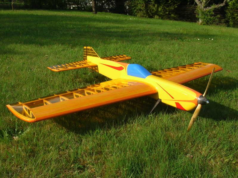

Here are some pics of BK2:
Here are my comments on some topics of this thread:
Why did I chose the unequal rib spacing?
1. It looks cool!!!!
2. I've not seen it before in F2B
3. It makes the planking at the root a bit stronger by supporting it. My first plane (Blackadder) got damaged when someone tried to hold it at the wing and broke the planking at the root with his fingers.
4. I designed the Wing in CAD and cut the ribs on a CNC machine. That means: Unequal rib spacing is just as easy to do as an equal spacing.
Does it add strength or stiffness?
I think it does. But I think the difference is small. To small to overcome the loss in stiffness and strength by using Oracover (German Monokote) instead of silk.
So why did I use plastic film instead of silk?
Because I think it looks cool :-)
I would also like to comment the weight.
Big Kahuna 1 (BK1) weights ~1580g (~55.7oz); BK2 is a bit heavier at ~1620g (~57.1oz). I think that is to light for such a big wing!!!! I don't know the wing area, but it was one of the bigger planes of the WC and EC and it was one of the lightest planes. It is like a feather in the wind. Every hiccup of the engine is instantly converted to a change in speed. Every gust and turbulence causes the plane to jump around. It is maneuverable, but far not as rock steady as other planes. It looks like Speedy Gonzales is trapped inside the plane, jumping up and down and round and round all the time.
Also: The light and stiff structure along with the Oracover film makes the plane very loud! Spectators report that, as soon as the bottom or upper side of the wing is visible (in a maneuver) the noise triples. Luckily the judges don't get to hear that much :-)
I love both planes and I hope they serve me well for the next years.
I'm curious what you guys are commenting now. I can't wait to read upcoming posts :-)
With kind regards
Frank
+ Sorry for possible spelling errors!

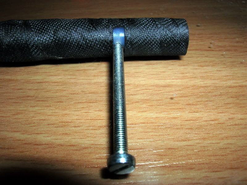

Let me answer the questions on the Flap / Elevator design.
The carbon tube used is, lets call is "homemade" :-)
I'm working for a company manufacturing such tubes on a filament winding machine. Every tube we make is custom made, so don't ask me about price. They are VERY EXPENSIVE!!! Go google for "filament winding" and you'll see that it is possible to make such tubes at home.
The inner diameter is 10mm, the outer diameter is 10,8mm. The fibers are orientated under 45°, giving maximum torque stiffness.
Each flap has 3 "hinges":
First I made little cylindrical parts from Teflon, diameter 9,8mm and 20mm long. Each of the Teflon pieces gets a lateral hole for a M3 screw. The carbon tube has a lateral slot of 3,5mm for every hinge. Now the Teflon cylinder is pushed into the tube so that the hole in the Teflon and the slot in the are aligned. Then a M3 screw is screwed into the hole and the head of the tube is removed..... That's it :-)
The part of the screw that sticks out is glued into the trailing edge of the wing. Now the tube can rotate around the Teflon +-30°, depending on the width of the slot.
The ribs of the flap and elevator are also CNC machined.
The trailing edge of the flap and elevator are made from 3x3mm carbon tube with rectangular cross-section.
Works really great as long as you use Teflon. Very little friction, very constant gap.
BUT:
Never ever use Nylon!!! Why? Rain – moisture – Nylon will expand – flaps won't move anymore. Been there, done that.
There is a lot more carbon used. Every thing that is black (except for the lettering) is carbon. The spinner and the landing gear is also homemade.
I tried to combine the strength and stiffness of carbon with the lightness of balsa and as far as I can tell, it worked out great.
BTW
BK2 is also powered by a RETRO 60. just like BK1.
With kind regards
Frank
