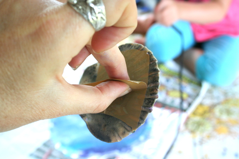

If the canopy material is not permanently deformed into that shape you could try making a little handle/tab out of masking tape or perhaps something a little stickier and pulling the dent from the outside like this:
A bit of gentle heat might be tempting to try if all else fails, but it wil lbe hard to get it where it needs to be without causing distortion elsewhere. Aluminium tape insulation could help. Consider heat a last resort.
