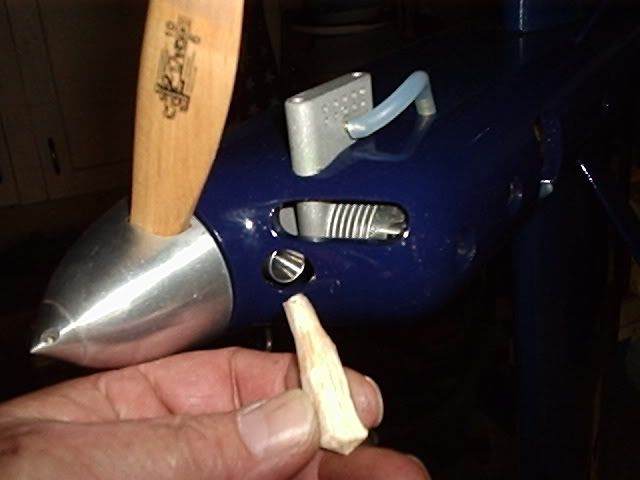

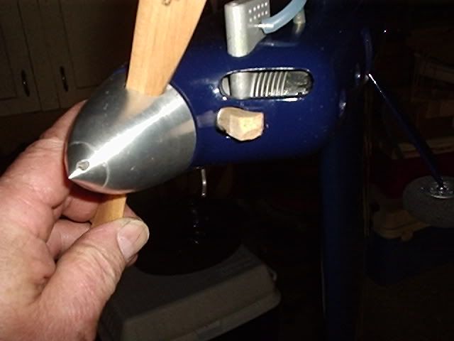

The only reason I put fuel in the venturi is because I can't get my finger in the cowl to prime it.  Tomorrow, when I fly hopefully, I'll put less fuel in the venturi and try to start it.  A report will come tomorrow if I fly, if not Saturday  H^^
Re: What am I doing wrong???
« Reply #18 on: June 11, 2009, 07:14:10 PM »
Matt,
I do this with all my inverted cowled engines. Its just a soft balsa plug that I ckoke with and it doubles as a storage plug.

« Reply #21 on: June 12, 2009, 09:46:28 AM »
I've been wondering what I could use to choke the LA40 in my Nobler ARF; well, I remembered that I had bought some blue rubber ear plugs at Wal Mart, but I didn't like them because they were too large for my ears, and very uncomfortable.  I just went out and stuck one in the venturi, and voila, I now have a good choking device.
