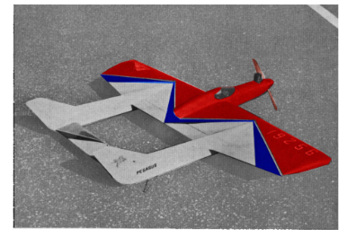

            Has anybody built the Jean Pailet Pegasus twin boom stunter with a flying stabilator or had seen the original fly? I have been looking at the plans and wondered how it flew. I find it interesting and have thought about building one with a few changes. I have the Model Airplane News March 1964 issue and read the article but there is not much information in it on how it flew. I would like to know how stable was in level flight and how it turn with the flying stab. if you have any info please let me know.

   I think the history of the airplane is, it was less than a success, so he cut the wing out of it and used it in another model that he published the plans for in Flying Models magazine, I just can't remember the name of it right now.
Zephyr
https://stunthanger.com/smf/classic-planes/more-from-new-bedford-invaders-meet-in-67/msg71802/#msg71802

13 years ago, I produced kits of all three of Jean's designs.  None sold very well. Here is the link.  The Skylark was the prettiest in my opinion.  The fuselages were all basically the same shape.
https://stunthanger.com/smf/open-forum/skylark-playmate-and-zephyr/msg157908/#msg157908

                  Thanks for all the replies they have been very helpful. I went to the link that Brent Williams posted on the Zephyr and found some comments by Bob hunt about the Pegasus and Zephyr that make me think that the flying stab did not provide the improvement Jean Pailet was looking for when he used it in the Pegasus. The clue is that he reverted to a normal stab and elevator on the Zephyr and with the same wing he was getting better performance out of the set up.

Mike mentioned the lack of response to his Pailet kit efforts. I was intrigued by the Skylark, which seemed to be a beautiful model---until I read about the odd control deflections it seemed to need. I just couldn't see spending the time to build a nice looking model that would likely have non-standard trim issues: (IIRC) a ton of flap to a small amount of elevator. There are other nice planes that didn't have a puzzling weirdness baked in....
It was also curious how he used "hardwood" fuselage sides in lieu of balsa....
